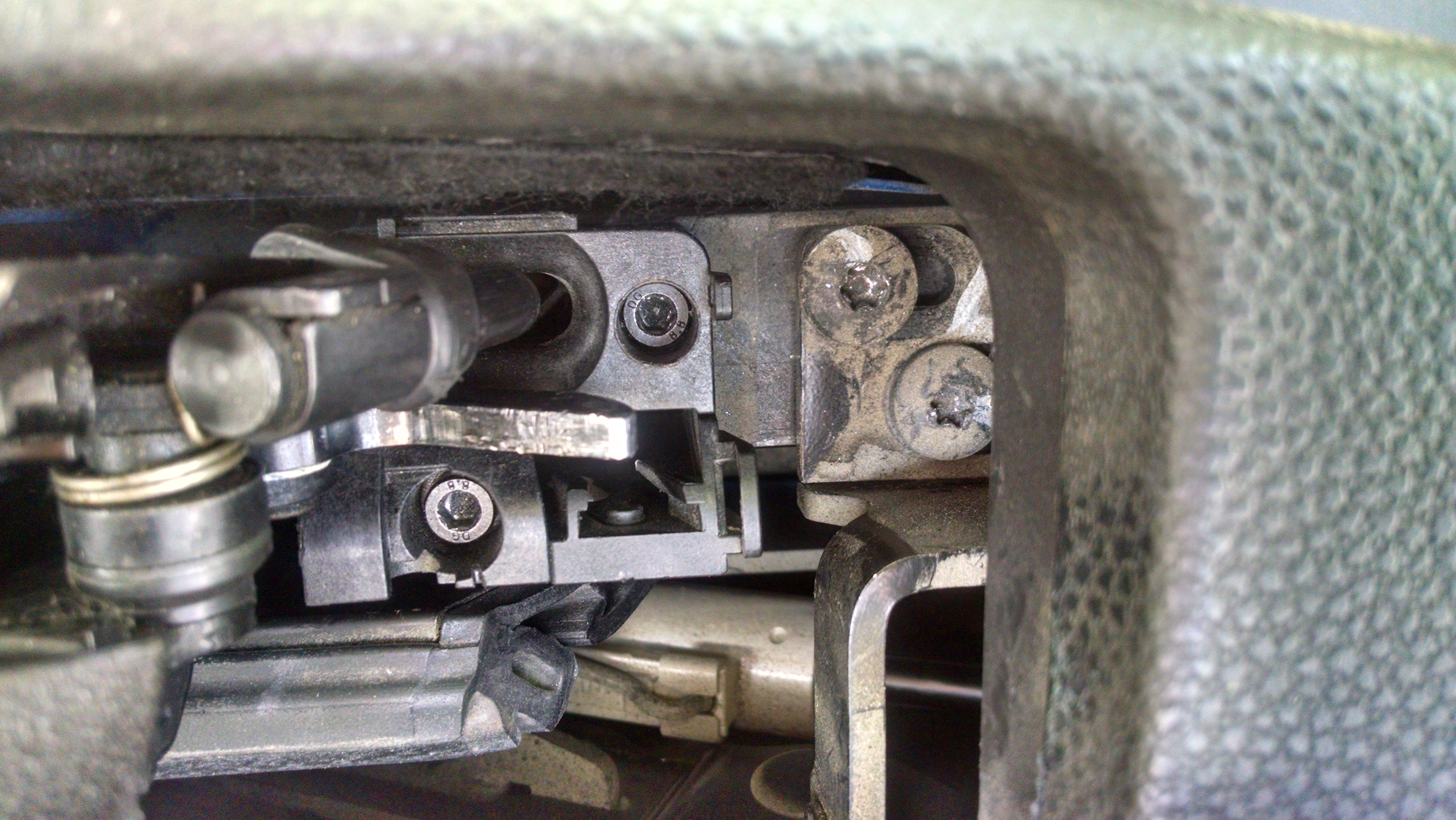

Found something missing..
This dang top is driving me crazy. I have gotten it to lock both sides when the top is open, but the top is not tight against the roll bar so the green light flashing/dinging, lock symbol on the steering wheel remains in effect. If I keep it going til it does go tight up against the roll bar, the passenger side comes unlocked for some stupid reason. I began adjusting the landing/interlock, and found that a piece is missing from that area.
And now the drivers side is locked open and the passenger is not, but the jaw is locked, and the top is stuck open...
Well, after further research, and using this page as a reference:
http://workshop-manuals.com/mini/coo...rams/page_111/
I believe that the missing part, as depicted in the first of the 2 pics I posted, is indeed a Hall sensor - specifically "Hall Sensor - main pillar stored". That makes total sense, actually.
Now, where to find a replacement...
