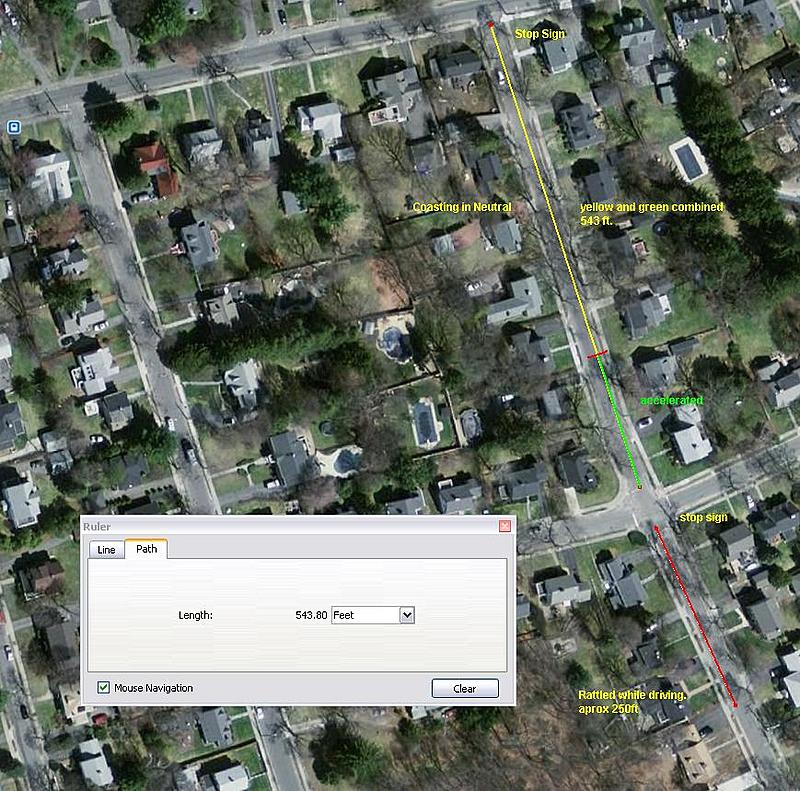

Ok, I've been meaning to post this for a few weeks but I think i've come across a way to get the cold start chatter to stop within a few hundred feet of driving after starting the car.
As we all know the car will chatter for a little while after being started and driven, It usually occurs between the 1500-2200 rpm range from what I have noticed.
First of all I have a 2008 Cooper S with an automatic transmission, 18070miles.
Ok so after starting my car one day I got the rattle. ugh. so in the days before I've been trying some hyper-miling techniques and had been shifting the car into neutral and letting it coast. So after driving around the block and it still rattling the street I turn down is on a grade, not huge, but enough for it to roll down on it's own.
so I turn on to the street from a stop and its still rattling and shift it into neutral and let it coast.
the road is three blocks in length and I was able to traverse it in under a min. total road time has been less that two Minutes at this point. when I get to the bottom of the street at the red light I shift back into drive and continue and NO MORE RATTLE! it was certainly the quickest the noise has ever gone away before.
So since then I have been doing this when ever I get the rattle, Like this morning. I pulled out of the driveway and now on a level grade street I drive to the stop sign in the diagram I provided (red line), then continue and shift into neutral about where I marked it (green line) and coast the rest of the street (yellow line) and when I reached the end of the block, A standard suburb city block, Rattles gone. I Google earthed it and I was able to get rid of the rattle with in 800 feet.
I have proven this to my self multiple times now and it seems to be a quick fix to the problem. I know that this isn't a permanent fix but I'm putting this out there for the people who just get it those times and want it to stop.
I hope this helps for some other people too
-Peter
