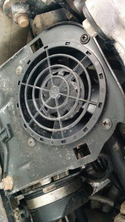

I drove up on ramps to take a look at the PS fan.
There doesn't seem to be any buildup, there is clearance between all the blades and the shroud.
But, I cannot turn the fan by hand.
The above comments make me feel like the fan should spin freely.
Also, this video suggests that if the AC is on with engine running then the PS fan should also be spinning
I started car and turned AC on, but the PS fan did not spin. Fuse is still good and PDC is working.
I assume this means my fan is dead, but am not sure about other ways to check function. I wonder what the service manual says about this.

You need a new fan. I bet if you unplug the fan you will quit blowing fuses. The fan does need to spin freely. You can remove the fan and try to clean it but I'm afraid the damage is already done. You don't want to risk a $350+ Power steering pump for a $100 fan.
