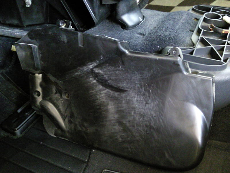

Hello Everyone, this is my first post, I´ve been reading so many post and this page has been so useful to me that now that my heater core broke and I couldn´t find any pictures to find the freaking thing so here they are
In the first picture you can see the two tubes that go to the heater core and the place where the core goes
On the second one, there´s the plastic cover that´s right next to the gas pedal, it has three gold torx screws being the one at the top left corner the hardest to remove.
But before doing that you have to remove the gas pedal, here, on the 3rd pic you can see the base of the pedal, take a screwdriver to take it off, it just slides to the left.
Hope it helps
Carlos
