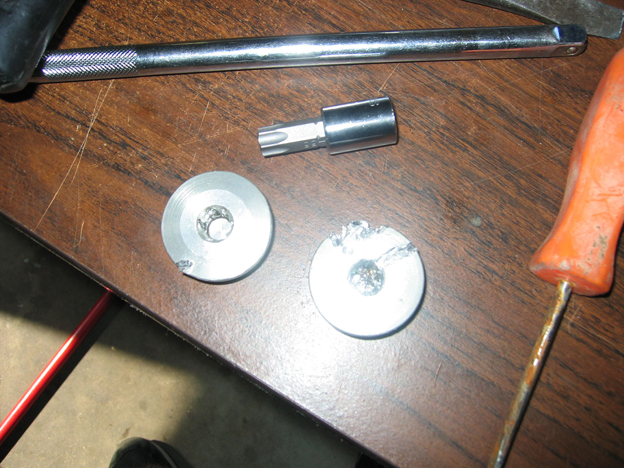

I am in the process of pulling my head, and ended up stripping out the allen plugs that are removed to access the timing chain tensioner. Does anyone have any suggestions on how to remove these?

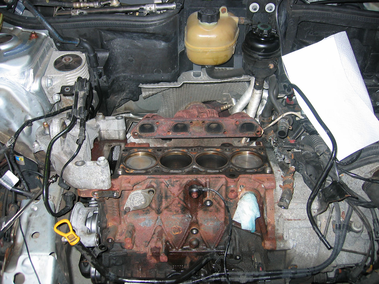

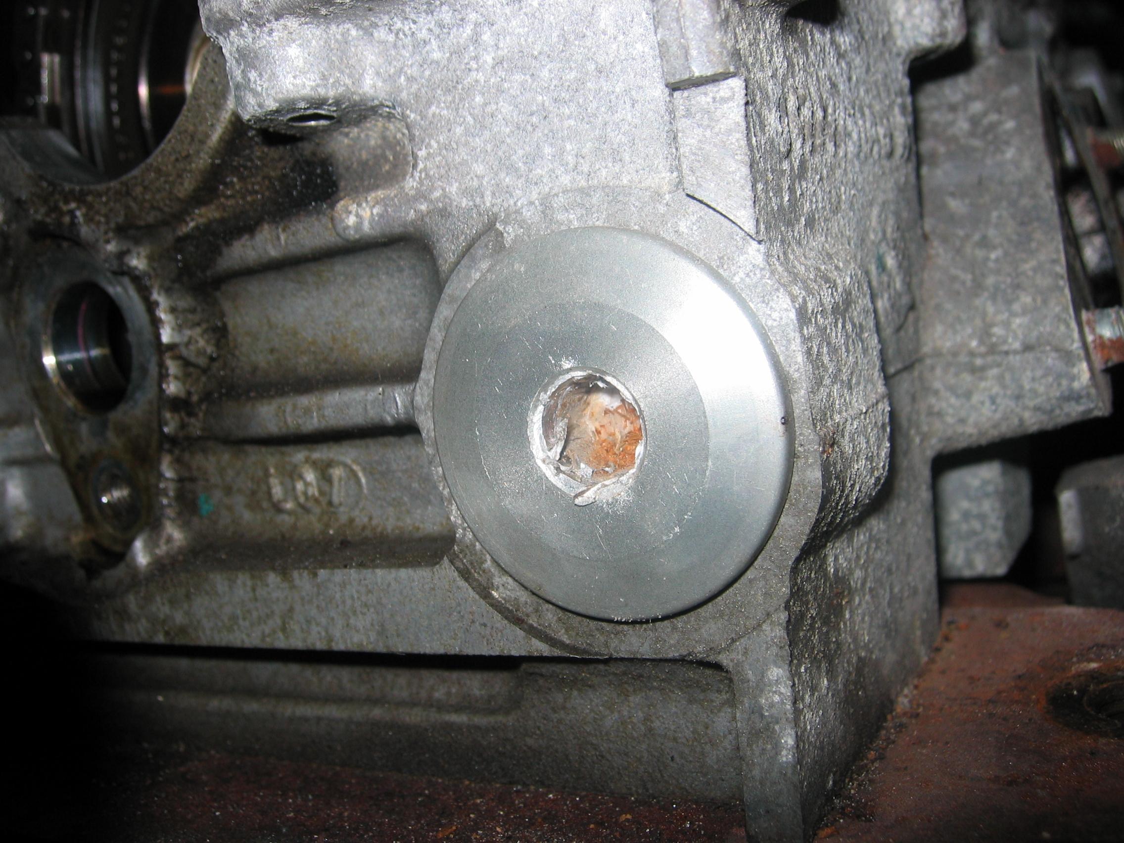

We'll I tried the chisel idea with no success. Then I tried my torx idea and it worked! The key was to hit it like an impact gun rather than a full sweep.
Head removal: how do I take out the two plugs to access the chain tensioner?-ptdmv.jpg
and
Head removal: how do I take out the two plugs to access the chain tensioner?-c0sxr.jpg

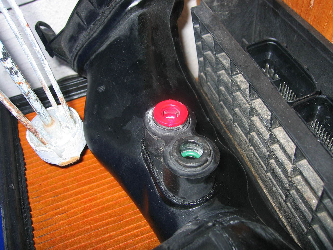

In the process of pulling the head, I forgot to disconnect the hoses going into the intake tube. So there I was balancing the head in one arm and trying to figure out how out the tubes with the other hand. Oil dripping everywhere and trying not to hit the valves or mating surface, I decided to bust the red piece off (this was before I knew that you simply hold it down while pulling out the tube ). Does Mini sell the red pieces separate?
