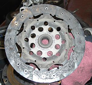

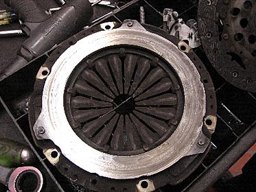

Hi, new owner of a used (2007 R56) Mini here.
Bought the Mini from a BMW dealership less than a month ago with roughly 22k miles on it.
Now, about 1000 miles later it is sitting in a Mini dealership with the sad remnants of it's clutch on a workbench.
I'm not sure what my best course of action is at this point. I know that I didn't drive it hard, but of course can't assert that the previous owner (only one owner) didn't either - although the sheer amount of damage would be impressive to rack up in such a short time.
Naturally I'm being denied warranty coverage from the Mini dealership since there isn't clear evidence that it wasn't user error. That's fine, and I'll call up Mini customer service tomorrow. However, what really gets me is that one would think that this type of problem should have been discovered/fixed at the dealership level before I bought it - I'd understand if I bought it from a private party, but not from a dealership.
Anyway, here's the pictures - please let me know if you have any suggestions on how I should pursue this, preferably without me being out of pocket $3100 at the end of the day!
Regards,
Terminal
Attached Thumbnails Clutch Warranty Help-clutch_1.jpg   Clutch Warranty Help-clutch_2.jpg   Clutch Warranty Help-clutch_3.jpg

And one final picture.

To me the pics make it look like the clutch just came apart. It doesn't look discolored like you burnt it up. Stick to your guns, they should warranty it.

It never was completely normal from the time that I purchased it. I in my ignorance assumed that the little slipping under hard acceleration was a function of the traction control more than anything else.
As for the comments regarding the dealership I purchased it from it's worth reiterating that I purchased it from a BMW dealership as a used vehicle. If they wanted too they didn't have to do anything at all, they at least stepped up to the plate.
The thing that confuses me the most is that the commonly cited reason the clutch wouldn't be considered under warranty was that it had a bit of bluing on it from heat. I finally figured out the clutch was having problems when it started slipping at high loads on the interstate - the first couple of times reaching almost redline.
This would cause a lot of heat, and probably the bluing. Therefore I was pretty much screwed at that point since the slipping of the failed clutch caused what they saw as clutch abuse.
