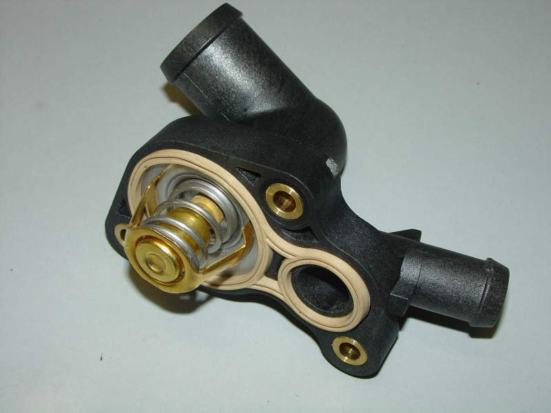

I wussed out on the DIY and had it done by an indy shop. However, I did get to watch so I thought I'd post some tips for anyone contemplating a DIY.
Executive summary
1. the IC doesn't have to be removed
2. the lower radiator hose doesn't have to be disconnected
3. not much coolant is lost in the process
Procedure
1. do not loosen or remove the coolant tank cap
2. unplug the cables going to the fuse box (the one in the engine compartment...)
3. remove the airbox and associated connecting tubes
4. jack up the left side of the car (this makes it easier to put a plastic catch container under the car and also changes the car's angle to reduce the amount of coolant loss in the next step)
5. remove the thermostat housing
6. replace the thermostat, seal and optionally the housing
7. reassemble everything
8. replenish lost coolant
9. start the engine and bleed the cooling system
10. rinse off any spilled coolant
I was surprised by how little coolant was lost during this procedure -- I'd guess less than a cup. I attribute this to the angle resulting from lifting the left side of the car and leaving the cap on the coolant tank.

I was just reading this thread. I did my thermostat twice... incorrect gasket the first time areound but it's my daily driver so I didn't have time to wait for the part. The Supercharger stays on just remove all of the intake hoses and upper intake box there is a group of wires that needs to be moved over as well.
The beleeding. there are two bleed points on the system. 1 is an 8 mm bolt right around the thermostat, i believe it was on teh block or manifold. and the other point being a plastic bleeder screw on the upper hose right at the from of the car. after changing everything over and filling the overfill up run your car to normal temp and open up the plastic screw (the other is a pain to work with) when you open it there will be steam. Once it stops steaming a small amount of fluid will ooze out. close it and make sure the fill level in your overfill is right and you are done.

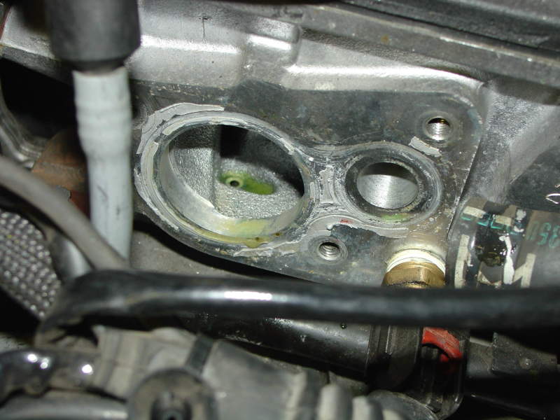

Replacing the thermostat really isn't all that difficult. Pelican Parts will soon have an article completed showing the procedure in detail. In the meantime, i can answer any questions you may have. In our case, someone tried to use sealant on the mating surface between the housing and the head. This probably made the leak worse.
