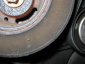

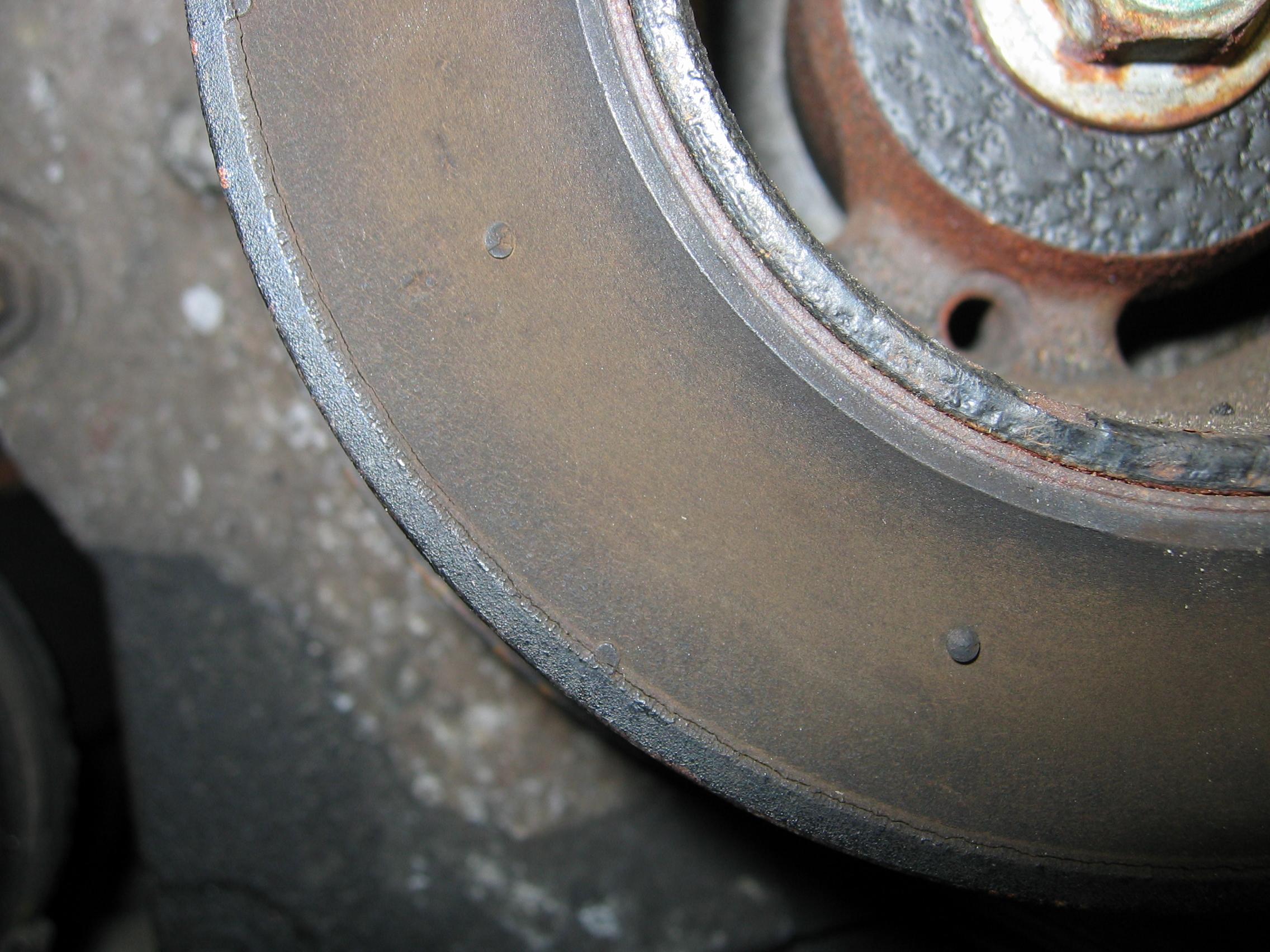

I've been getting the playing card in bicycle spokes noise for the past few weeks and finally pulled the liner to look at my damper. To my knowledge this is the original 2002 damper with 78000 miles on it. It has this what looks like a crack pretty much around the entire pulley, but I can't really tell if it's just the seam between the metal and rubber or if it's a crack causing the noise.
I also noticed that when the car is running, the damper doesn't look completely straight. Comparing it to the other pulleys in the system, it kind of wobbles very, very slightly. It looks as if it was a photo that's not completely in focus, the edges kind of blur, I would say less than 1/16". Probably more like 1/32".
Any insight would be helpful. Thanks.

Old Feb 18, 2010 | 06:11 PM
fullcollapse40's Avatar
fullcollapse40
Joined: Jan 2007
Posts: 226
looks pretty normal from my house
Old Feb 18, 2010 | 06:47 PM
ToBFree's Avatar
ToBFree
Joined: Sep 2005
Posts: 593
From: Rootstown, OH
Such a quandary. The visible wobble when rotating would bother me. Sad part is you won't really know if it's going bad until it explodes and damages everything else nearby. I went the lightweight Alta 2% route 45,000 miles ago but wouldn't necessarily recommend that. There are a couple nice (and spendy) dampener crank pulleys out there or go to the later model OEM. Don't put the '02 version back on. There are some threads on the subject here and there.

Eventually, it will look like this...........

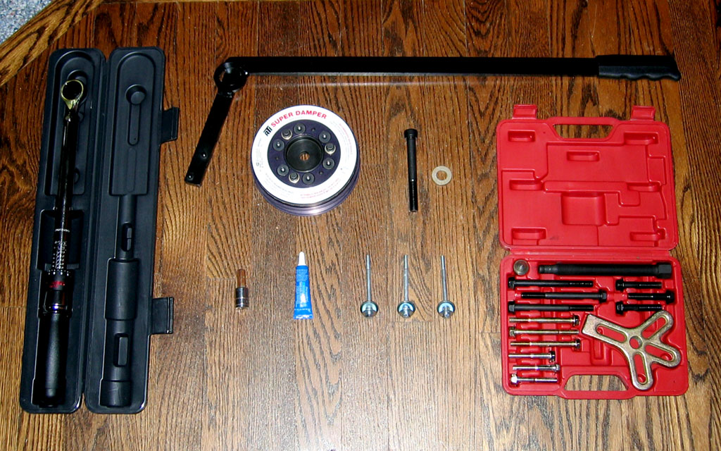

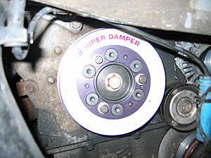

Well I received the ATI Damper today, a very nice product indeed. Went to Autozone and used their loan-a-tool program to rent a puller for free. Then I went to Home Depot, purchased 3 M6 bolts and washers (I hope they are long enough!)
I also picked up a Husky 3/8" torque wrench (chose Husky for the lifetime warranty and convenience of Home Depot). It does 20-100 ft/lbs. I could have purchased the 1/2" 20-250 ft/lbs wrench for $4 more, but it was excessively long and I feel I would get hung up a lot. Up to 100lbs should cover most everything on the car except the axle nuts.
Here are a few pictures of the pre-install. Expect the install in the next few days.
In this picture you can see:
tensioner tool
torque wrench
ati pulley w/supplied M12 allen bolt and washer
harmonic damper puller kit
blue threadlock
10mm allen socket I had left over from my old 7M-GTE headbolts which will help the installation immensely
short of a standard toolkit, this should be everything I need for the project.

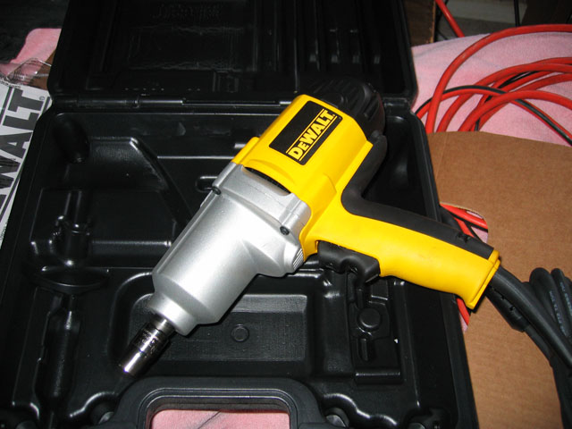

Did the install today and it went surprisingly smooth except for one problem, not having an impact gun! I ended up running out to HD and picked up up a Dewalt, which I will probably return and buy something cheaper online .

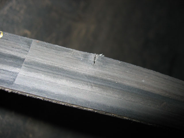

When I took off my belt I found this! This belt is under 5000 mi old. What could be the cause?

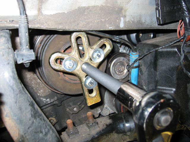

My Savior!
The removal is very, very easy with this tool. There's absolutely no reason to purchase the OEM tool IMO. I used the supplied allen head bolt that came with the ATI damper to press against which worked perfectly.

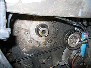

OFF!

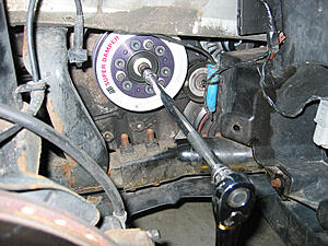

Using the supplied allen bolt and washer to press the pulley on. I didn't need to heat it up at all.
The allen bolt only pushes up to a certain point, they you use the oem bolt to finish it. Once the bolt no longer turns, back it out and check to make sure the pulley is flush with the crank by looking through the center hole. If all is well, put blue loctite on and tq down to 85!
My only concern is when I was torquing the bolt. Even with the brakes pressed firmly and car in a high gear, the crank still had a bit of twisting play in it. I would say the crank turns about an 1/8th or so while I was applying pressure. Once pressure was relieved, it twisted back (I'm guessing this is play in the dual mass flywheel springs).
Do you all think this twisting will effect the torque value drastically? I cant see any way around this short of the oem BMW tool 525-135.
