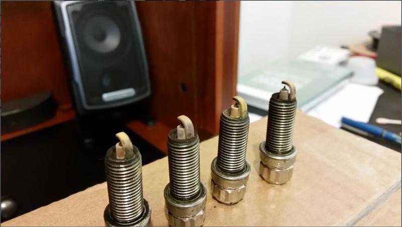

Does this picture of my spark plugs (3k miles on them) look lean to anyone? There are 2 plugs light tan on the electrode and inner porcelain area, the other 2 plugs are tan on electrode and grayish color on the inner porcelain area. Doesn't gray mean I'm lean?
