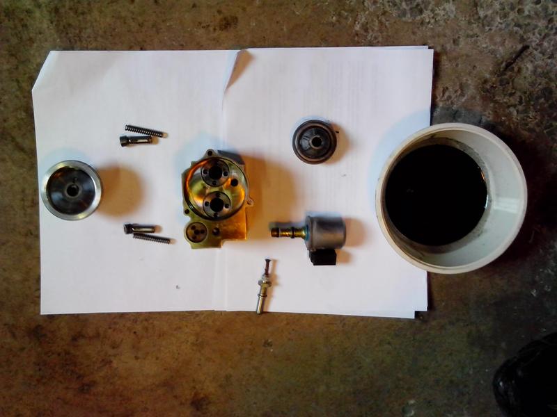

My HPFP started acting up a month back. The colder it got, the more likely it would start, stumble or stall, and drive poorly until the pump started to warm up. Fuel economy was also getting worse as time went along. I did a hand full of data collections on the motor at start up and found it would not make the 50 bar at idle. Sometimes when it stalled, fuel rail pressure would spike way up just as it stalled. This seemed to match the general information about the pump not making required pressure and possibly the solenoid that directs fuel to the rail sticking.
Ordered a new pump from ECS Tuning and replaced it yesterday. Biggest problem is pulling the fuel feed line off. The connector requires a special tool or a carefully modified cheap clamp to squeeze it just enough to get the catches to release. After a cold soak overnight at 6 degrees it started right up this morning and idled fine.
So, being a curious individual I pulled the old pump apart to see what makes it tick. The attached picture shows the parts I was able to disassemble. From left to right:
1. The drive assembly that fits into the end of the camshaft. The pump interior is a disc tilted about 30 degrees.
2. two pistons with the return springs that fit internal to the pistons. The tops are set on a ball end to follow the drive disk as it spins around.
3. The main body. the two holes in the middle are the bores the two pistons fit into. At the bottom of the bores are complex mechanisms, possibly on a spring. Could not get the bores apart without major effort.
4. Just below the body is the fuel inlet. Note the small filter fitted inside the inlet to catch any random junk that makes it's way past the in tank filter.
5. Next is the oil sump (top). It bathed the pistons and drive disc in oil. The oil sump is an interesting assembly. Its a spring loaded reservoir for the oil that you see in the plastic cup at the far right. The oil is as black as it appears in the picture.
6. The solenoid (bottom) that may be the culprit in the failures. Surprised they don't just replace the solenoid as it is retained by two screws and comes right out without issues.
Would love to have gotten this further apart but some parts appear to be pressed in and I didn't spend the time trying to get it further apart.

Glad to hear it went well! Is the new pump different versus the old? How much is a HPFP anyways, not dealer price though? I heard from my local dealer that Mini stopped using the manufacturers that sold the defective ones. The 2013 HFPF's are different looking.

The new pump thru ECS Tuning was only $200 which was not bad. Installation was only about an hour discounting the fooling around making a fuel line disconnect tool out of a cheap clamp.
Can't say the new pump looked different from the old pump externally. I just did a quick stare and compare before throwing the new one on the motor.
This morning at 12 degrees it started right up and idled fine. Afraid though the fuel economy is still down (5 mpg below normal). Hate to think I have a faulty fuel injector now to sort out. May be pull the plugs this coming weekend and see if any look suspect.
