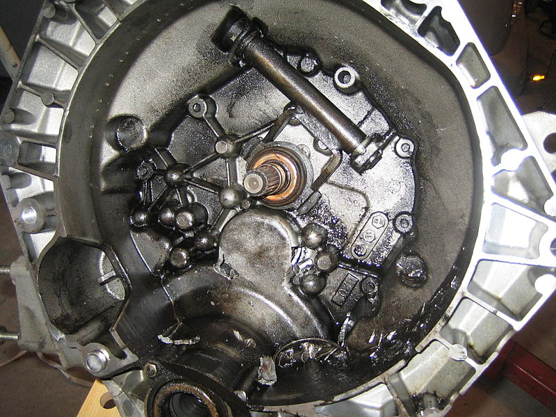

I have a grinding noise on my 03 mc. It is a manual and it sounds like it is coming from the lower left drivers side. I think it may be the transmission but i don't have any performance or shifting problems. I am adding a sound file so you can listen to it. It is not the best quality but you can here it. In the sound file i kept pressing and letting off the accelerator so it would be more pronounced. The sound does get quite down if I depress the clutch but is not completely gone. Any Ideas?

Change tranny fluid and ck for metal bits. May let you know whats going on inside

Found out what it was. The transmission locked up while I was going to work. I am in the process of replacing it now. I am also going to replace the clutch while I am at it.
