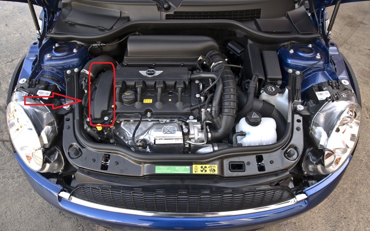

Hey NAM, looking for some info on my 08 MCSm. Recently (2-3 days ago) my engine starting making this squeaking/squeal noise from the left side of the engine (see attached image for location). It's not really that loud, but you can hear it while idle at a stop with the windows down. It's fairly inconsistent, you can restart the car and make it go away sometimes, but eventually it will return. I must add that it seems to have started after I washed my car this past Sunday (I may have sprayed a bunch of water down the hood scoop), not sure if this would have any effect.
The MINI has 10500 miles on it, and also has the cold start death rattle, which happens off and on even when the weather isn't cold (might be related?). I recently took it into the dealer to have them look at it, they concluded that the oil level was low (topped it off for me, and actually overfilled it), and also did a bleed in procedure for the VANOS. The cold start rattle came back the next day! I also didn't get a change to take out the extra oil (been about 500 miles since the service).
That's about all I can think of that may be related.
Any info/help is appreciated,
OPish
P.S. the car in the pic isn't mine =P

You probably have a waterpump issue discussed in this thread:

WOW! That's totally spot on. After listening to it from some of the videos, sound is exactly the same. It also seems to happen after the engine has been run for a while, my commute home from school is about a 20 min drive. It has been pretty much the case that I hear it once I'm off the freeways.
I'll probably leave it be till I go in for my first service, doesn't seem extra hazardous to the car and I'm also ultra annoyed with my MINI service department...
Thanks Chadtoolio!

Water pump!! took some convincing on my part to the Dealership. They did their research like me and replaced it. No Squeal!!
Squeal is back now after 4k miles :( Ugh..

The next one that comes in, I think I will rough up the pulley a bit and see if the noise changes. Maybe a friction noise of the two pullies on one another. Hard to believe there could be a bearing making that noise. I mean how long have they been making w-pumps.??

yeah, but the plastic impeller problem is different than a squeel. Besides this is a Peugot joint venture engine.
