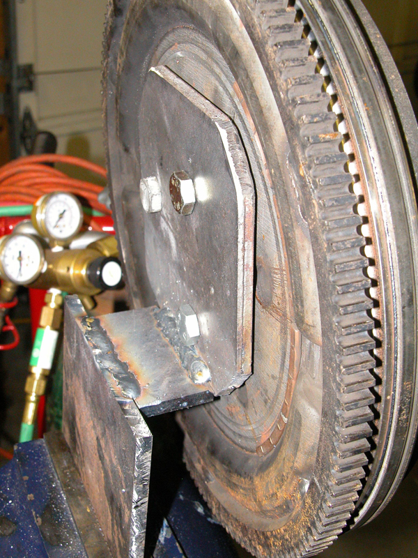

Thanks for the suggestion. I made a fixture that I could bolt to the hub of the flywheel without interfering with the outer disc. I can rotate the flywheel and it will spring back, suggesting that the "shock absorber" function is working. I grabbed it like a wheel and tried to rock it to test for radial play, and did not find any other than a slight flex from the rubber core. Based on this exhaustive analysis, I suspect the flywheel is still good. The flywheel only has 56,000 miles on it, anyone know what kind of lifetimes have been seen for dual-mass flywheels? If this was a solid flywheel I wouldn't be concerned at this mileage.

No, it applies to all versions of the MCS. The update was due to the fact that the flywheels would glaze over create all sorts of weird noises. How far were you able to rotate it? Given that it has to transmit all of the torque from the engine I would have expect it to be impossible to rotate like you did.
