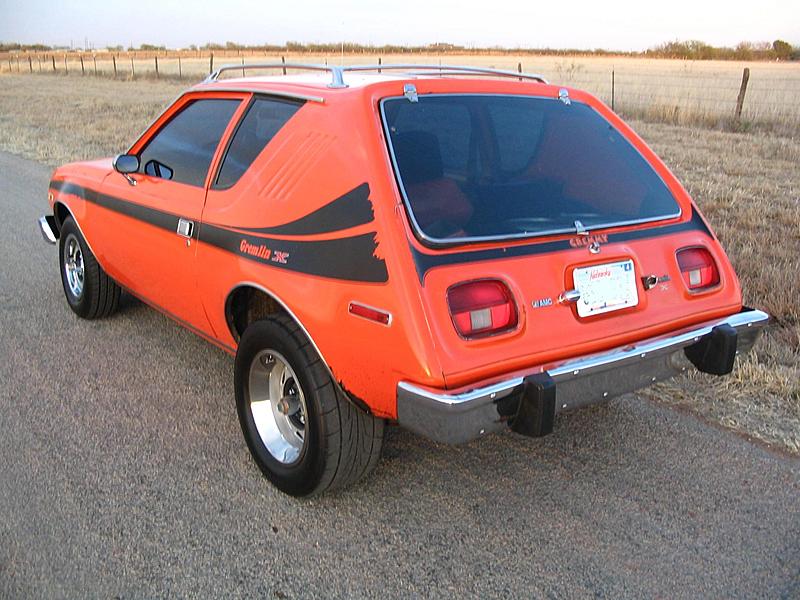

I havent had that Gremlin but i do have this one.

cool! is that a Gremlin X? I had a 1973 G-X when I was in high school that had the AMX small block V8 crammed into the engine compartment, I forget the displacement (401 cu?) Man did that car move

Btw mine is a 401.. currently the engine in it has maybe 375 hp it would run 0-60 consistantly under 5 sec... I have another 401 waiting with maybe 400 + but I keep the car in storage and I have to take a vacation and travel 1500 miles just to work on it. I think next summer i will be able to my vacation to install it.
I will say I like boxy cars.. The Mini is would be nice to suppliment the 7mpg i get with the Gremlin.. I kinda laugh when others complain about the price of gas.. My current daily driver is a 1978 Jeep Cherokee Chief (another boxy car) gets 8 mpg. That has a 401 too. I will say with current price of gas now. Its like getting a nice pay raise..
I am still looking to buy a brand new Mini, I have been looking for a year lol
I am thinking to go all out on the JCW.. but its amazing the amount of little problems these cars seam to have.. I guess it wouldnt matter that much since it wouldnt be a daily driver.. I guess its tricky packing so much technology into such a small package leaves for bugs.. (does that make sense?) I will stop babbling
Thank You for the compliment
