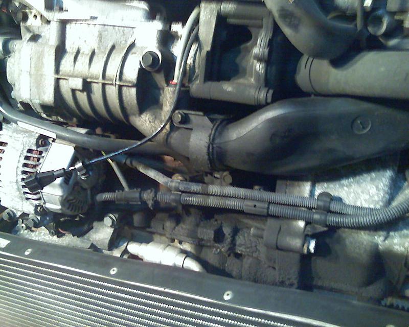

In the course of working to install a supercharger reduction pulley on my 2004 MCS this weekend (44K miles), I found evidence of a leak in the supercharger area. Here are some pics - while some of this may be from the breather tube, it seems unlikely that it would all be from this source - especially considering the amount of oily residue on back of the water pump (I did begin wiping off some residue before realizing how large the area was). Thanks in advance for any insight / recommendations..

After more research and carefully looking at the car, appears there's oil around the seal where the water pumps fits to the supercharger. Suspect this may be due to oil blow by on the water pump side of the supercharger - any thoughts?

There are 2 fill locations on the supercharger - one on the pulley end, another on the water pump side. An apparent increasingly common failure is the loss of lubricant on the water pump gear drive side (supercharger looses oil, drive gears are eventually destroyed due to lack of lubrication). According to BMW, the oil is "lifetime"; however, in order to access the fills, much of the front of the car must be removed for the water pump side (pulley side is fairly readily accessible). In my case, it appears that most or all of the oil pump side oil may have been lost due to failed gasket/seal (until the supercharger itself is pulled, it's unclear if the gears may be damaged as I've not heard the telltale supercharger clatter at this time).

I was wondering what the final results were regarding your oil leak at the s/c? I saw the thread and have a similar issue but there seems to be no final word on where it was coming from. The back of my s/c where it connects to the air duct is wet and oil can be traced all the way down the front of the oil pan. The water pump is not making any noise. However, I am not sure it is the lube from the s/c. It seems to be a much greater quantity then 2 ounces. I was wondering if you could update the thread with your results so that I can order the parts prior to tearing it down. Thanks
Anyone else have a similar leak that is causing the front of the block to be wet? My cooper is a factory 02 with 100,000 miles.
Old Oct 22, 2008 | 08:46 AM
k-huevo's Avatar
k-huevo
Joined: Aug 2004
Posts: 1,629
From: Pipe Creek, Texas
There may be only a leak from the SC intake duct gasket due to oil saturated crank case vapors, but this a good opportunity to service the supercharger anyway. Take a look at post #71 here https://www.northamericanmotoring.co...t=74674&page=3 to get an idea of what to expect. You will need an O-ring for the water pump to block tube, supercharger intake duct gasket, 2 in OD band/hose clamp for the BPV hose section, 2 X 4oz bottles of supercharger oil, 1 gallon 50/50 mix coolant, and 1qrt Acetone to flush the intercooler internally (if you’ve not done that in the vehicle’s service life). This is optional, but if the IC bellows have not been replaced, 100k is a good time to do that also. Be sure to plug the dipstick hole before removing the water pump from the block.

Thanks for the reply and info. I finally got around to tearing it down this weekend. The water pump side of the SC was low in fluid. However, there was some left in (maybe ½ an ounce) and nothing appeared to be damaged. I will send it off to get rebuilt b/c of the high mileage on it. The drive side had more fluid (close to the fill level) but the fluid was darker in color. Anyway, my question is that I am still not convinced that the fluid on the block is the SC lube. Has anyone seen anything similar? See pic. Any ideas or comments?

The supercharger fluid is used both in the nose gear section as well as the rear water pump drive gears.
