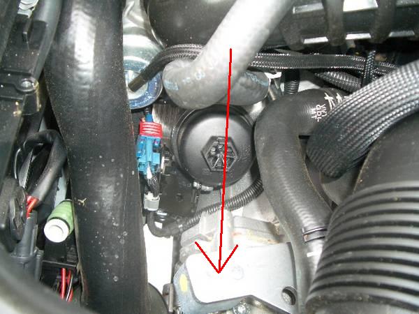

I may have found the problem and a solution... In the picture I've attached, you'll see a part that sits just under and slightly behind the radiator overfill reservoir as you look down from the front of the car. This thing attaches to the gear shifter through a cable and sits on top of the gear box. If you wiggle this part up and down you'll hear the very clanking sound you might be hearing and I was hearing in my car. I attached a 5 inch spring from the hole you can see on this part down to a clamp almost directly below this part. You want the spring to just have enough tension to keep this part from clanking around but not too much tension or it might make your shifting difficult. My clanking is gone at a last and my shifter feels more solid and not so wiggly!!! This should be service bulletin or something, some dealerships are changing all sorts of parts and not fixing the problem. Try it and see if it works for you, it's worth a try and it worked for me.

noise
Thanks. I believe that was one of the first things they checked. believe it or not, the car is going back one again to get all the details worked out, for the third time. I will bring your picture and description along so they can check again. Thanks.
I think this is my noise! It looks like it might be associated with the hill assist mechanism. I got my son to wiggle it while I sat in the car and it sounds just like the noise I'm hearing.
I'm pretty sure that's my problem too and that's why I was so glad my service department was focusing on that area.
My transmission was supposed to be removed yesterday but they realized the clutch release fork didn't come in. This was one of the parts the engineers suggested ordering bofore tearing into the transmission. Of course the part isn't here in Hawaii or mainland US; it has to come from Germany and it could take several weeks! I'm starting to feel a hint of remorse for buying a Mini and hopefully it will be quickly erased when I finally get my Mini back FIXED and in the same great shape I dropped it off in. I wonder if it wouldn't have been quicker to just replace the whole transmission and be done with it!
