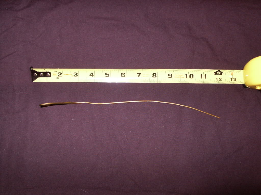

Actually, I have a cold and I'm too lazy to go out and bring it in, take a couple pics, and upload them. If really, really, needed, I can.

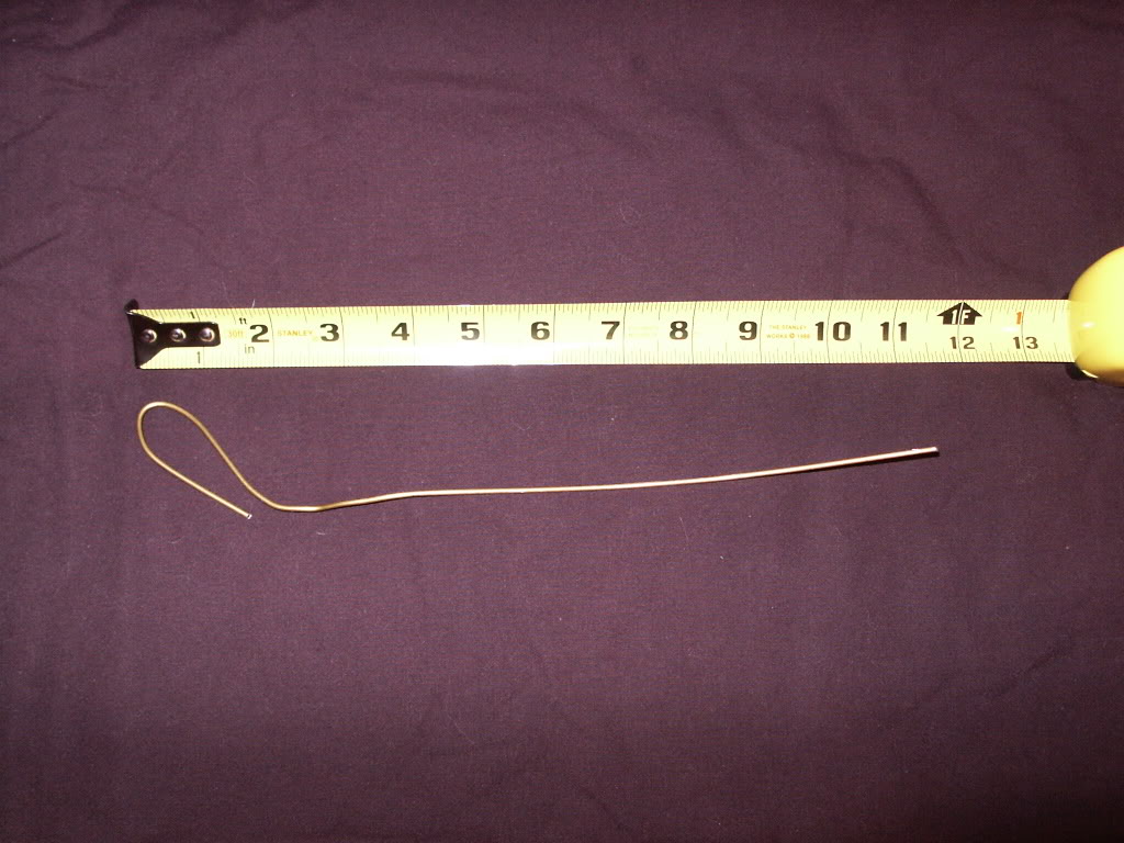

Start with a 14" - 16" straight length of coat hanger. [edit: if you have 2 gauges of coat hanger, use the heavier weigh material, but not more than 1/16" in diameter, do not use hangers with stick on felt slips, loose felt slips, or vinyl coating. The kind from the professional cleaners that are free are best.] Loop a couple inches at one end as a handle. Bend the rest in a slight curve with a radius of maybe 18". Clean up the tip a little so it is free of burrs and sharp edges.

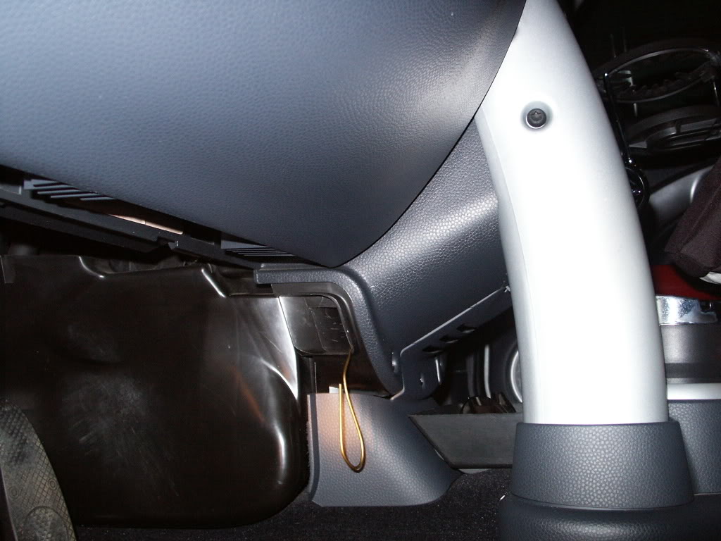

On the driver's side, just to the left of, and behind, the left down tube look for a one inch or so square hole in black plastic. It will have a just a little air leaking out if the heater is running in auto mode. Fish your new heater tool up there, curving first upward, then twist a little counterclockwise when you start to feel something in the way. If you hit the right spot, you'll feel the damper push upward and the warm, filtered, air blow across your hand. Be gentle. If you pull it out a little, the damper will thump back closed. Remove the tool if you need serious defroster, though both the footwell and defroster will work together just fine.
Ok, I went out in the cold dressed in my bathrobe and slippers to get these shots.
Heater Defeat Tool Location
Heater Defeat Tool (front of MINI view) Like from your gas pedal.
Heater Defeat Tool (bottom view) I think, My head started spinning.
The writer takes no responsibility for any part of your MINI you damage using these instructions, that your spouse smacks you upside the head for taking and cutting up her fav coat hanger, or that the heater fixes itself and later fails again (keep the coat hanger close at hand). Summer operation standards pending a real hot day to actually test sequences and new tools being developed in a MINI basement.
I'm waiting for the US Patent and Trademark Office to get back to my attorney.Actually, I have a cold and I'm too lazy to go out and bring it in, take a couple pics, and upload them. If really, really, needed, I can.

Thanks for the photos! Now go back to bed!
Thanks for posting the photos! You really did not need to go out in the cold in your bathrobe when you have a cold just to take these photos. You are too nice! Now go back to bed and get some rest! By the way...I am the "she" and my spouse is the "he" so I don't think he will really care about destroying a coat hanger!
