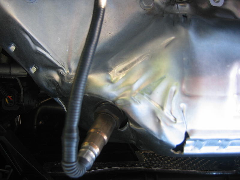

I took delivery of a 2007 MCS manual (November build) a week ago. I love how this thing drives, but I have a few problems which I would welcome input on in advance of its trip to the dealer in a couple of days.
  1. When it's cold outside (low 40's here in LA) and the engine is cold, it is difficult to change gears, especially between second and third. It seems almost to grind. When the engine warms up the shifting is easier but still somewhat notchy. I have driven only manual transmissions in my too many years of driving and have never experienced this before.
  2. When I was sitting at a stop light yesterday, I heard an intermittent high-pitched squeal, almost like fingernails on chalkboard. I couldn't tell where it was coming from, but assume the engine area. It only lasted a few seconds and didn't recur or seem to affect the car's driveability. I have no idea what this might be.
  3. Under the hood near the front of the engine there is a housing that appears to be made of aluminum. This housing has what looks like a tear in it and appears to have been hammered into shape. I am trying to attach a picture, but it's a little blurry as my camera was having a hard time focusing. Is this it's normal appearance?
Attached Thumbnails Seeking Input on Transmision/Engine Problems-img_3048.jpg
1. is normal
2. I believe the sound is a water pump squeal. I'm having the same problem as are others. There are videos on youtube that display the sound, and those that posted the vids say the dealer told them it was the water pump. I'm waiting until it does it constantly so I can take it to the dealer. The dealer wont fix it until they acutually hear it.
3. that is your turbo/exhaust heat sheild.....normal

The housing is just a heat shield for the exhaust manifold and turbine side of the turbo and the hole should be fine. You could complain a bit about it to plug the hole, but I doubt it would make any difference.

#3 is normal. that is how the compound bend is formed on the heat shield.
