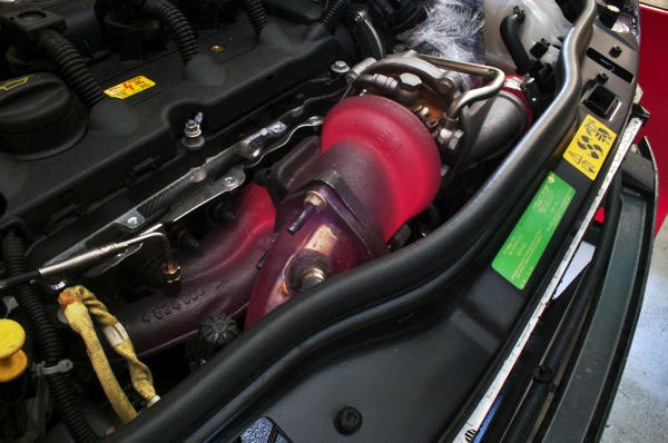

This is why the hood gets hot , awesome isn't it? The Mini Cooper S is a sports car turbo's get hottttt LOVE IT!!!!!!!,

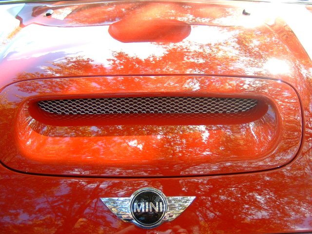

...Frankly....IMHO...It looks like crap with the scoop grill out. I might put mine back in after opening it up some with a drill or something...
I took mine out and replaced it with a piece of gutter guard material I bought at Home Depot for $1.20. It has a squished honeycomb pattern just like the grill. I left mine aluminum colored and it looks great, but it could be painted black also. It made a HUGE difference in the temps on the hood. My original scoop was completely closed.

What a classic picture!! What I do now is open the hood when I pull it into my garage. At least it might slow down the scoop melting/warping.
Cool idea!! I will look into it.
Photo please!!!

Here's a quick snapshot. You'll notice a small tear in the material in the upper right area. I slipped with the tin snips when cutting it out and just haven't gotten around to making a new one. The gutter guard is big enough to make four of these so you can make them in different colors and swap them out to fit your mood.
