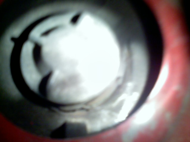

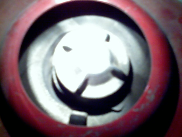

That "clunking" I am betting is the upper strut support! This is easy to check too.. At the top of the front struts, there is a black-mushroomed disc, look for any cracks going around the disc. I have an 03' w/53k and have had to replace it twice now. I always contributed it to the rough roads I travel but it seems to be a fairly common problem. It's not too difficult to change yourself if you a bit mechanically incline.

thanks for the tips. i checked the strut towers and both of them have what looks like a rubber bushing that has ripped/broken around the top of the strut. i'm pretty sure this is what the problem is. i took pics of this with my phone. sorry for the quality. is this the part you are talking about or is this something different. thanks for the help.

Yep! Unfortunatly they will both need to be replaced Check this thread out though. Might be able to get more info. If I recall, the actual part cost about 35$ each side and took me maybe 2 hours each to replace (taking my sweet ole time about it), but I had never done any repair like it before. I would prefer to work on older american cars but I wasnt going to pay the dealer to do it.. lol :impatient

For more negative camber up front the stock guide supports can be replaced with fixed or adjustable camber plates. The fixed plates from Ireland Engineering have a similar rubber bushing around the upper bearing like the stock piece so they are not quite as harsh as solid mount spherical bearings found on most adjustable plates. http://www.lonestarminiclub.com/foru...read.php?t=361 For the installation it will be the same as replacing the front springs https://www.northamericanmotoring.co...ad.php?t=92737
Some deformation of the strut tower usually accompanies a torn guide support bushing so be sure to inspect the tower above the strut. Lots of info can be found in many threads here on NAM about this issue. Here is one on another forum that covers the basics http://www.mini2.com/forum/wheels-ty...shrooming.html .
Placing one of those “plates” you mentioned above the strut tower will do nothing for preventing this deformation from occurring so spend your money elsewhere.
