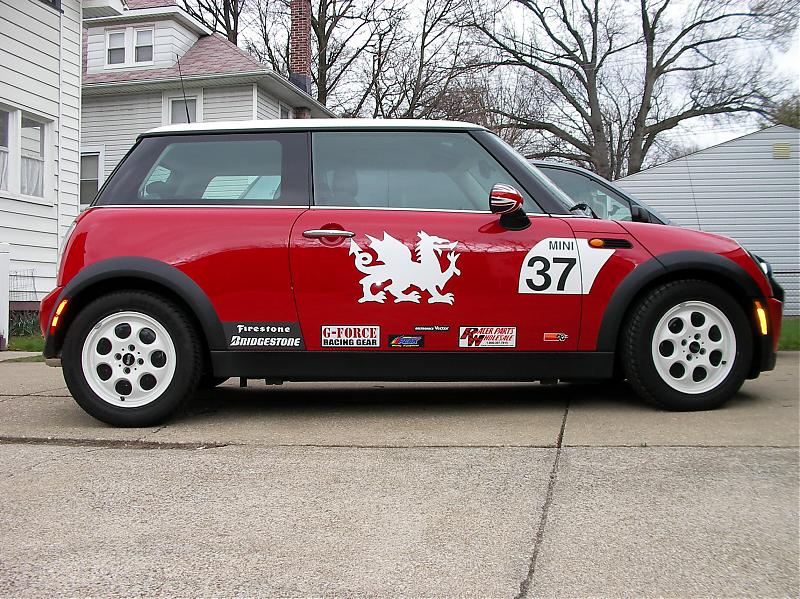

Clean wheels the easy way
I hate brake dust too, doesn't everyone. Now some people will start screaming, let them, I have used Kleenwheels brake dust shields from the first day I brought my Mini home. I love them!!! My wheels stay clean for weeks! I wax my wheels every 6 months or so. Now I do take these shields off when I go to the track or on the Dragon. I have 24,000 miles with the original OEM pads. I have never had brake fade or warped rotors.
