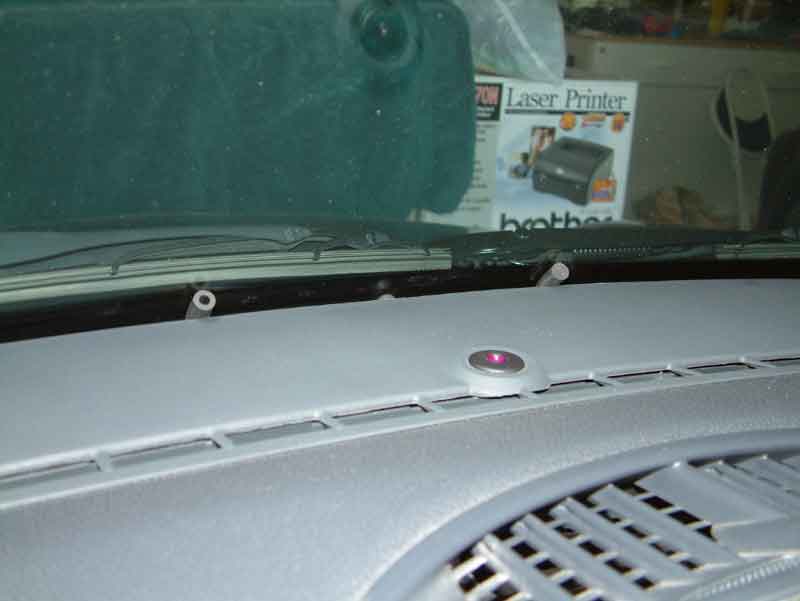

From: Fullerton, CA
I too, had a creak in the dash which would go away if i pressed down right around the A/C sensor. I asked the dealer about it and they told me that there was a fix for it, as wsj3200 and DPCooperS mentioned. I really wasn't wild about having them remove the whole dash to fix it. I read on another thread either here or on mini2.com that a guy fixed his creak by putting some molding from a household window along the gap between the top of the dash and the windshield. Apparently, some windows in a house are held in place with a trianglular piece of rubber molding. The right sized molding fits in the gap and acts like your hand when you hold press on the top of dash.
I looked around the garage for something that would do the same thing. I finally found some fuel line hose that did the trick. I pressed two 1" pieces of fuel line into the gap. The fuel line was just large enough to fit in the gap with a enough pressure to push down on the top but not enough to bend the plastic.
It looks a little odd but I haven't hear the creak in six months nor have I made it down to the glass shop to get some of any window molding. The creak is gone so it just hasn't been important enough to make the trip to a glass shop for something better.
Here's a picture. The flash makes it easy to see the tubing. Without the extra light of the flash, the tubes are hardly visible.
