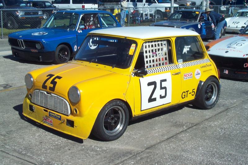

I raced my GT-5 mini for 10 years, about 60 race weekends, and never had to change the clutch disc. I wore out syncros, before I went to a dog box, but never had a clutch problem. I always used a heel & toe technique on downshifts, and always at high rpm's. I talked to a new mini racer at the daytona national in may who lost a clutch in just several weekends, apparently from not using a heel & toe on downshifts. In my new race Mini I have and will contiue to heel & toe on downshifts and save my clutch..

The first race mini is a 71 shell, semi tube frame, 1310 cc full race engine, it uses weber carb, electromotive crank fire ignition,13.5 to 1 compression SC/CR dog box, goodyear slicks. The new race mini is my 2006 Mini Cooper S SSC racer
