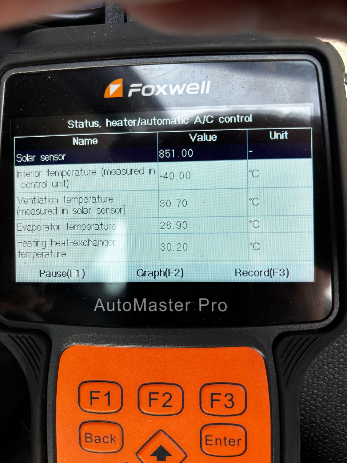

Hello from over the pond.
Trying to resolve an issue with the wife’s Paceman 2014MY, fitted with IHKA climate system.
The internal temperature sensor has decided to have a dicky fit by permanently showing -40deg C, as such the AC only gives warm air.
This sensor is built into the climate control panel which includes the display and controls as one unit.
The UK Stealership want over £800 of my English pounds - ouch!
I’ve found used unit for considerably less but cannot find out if the unit is programmed to the car or not….has anyone been through the same issue…?
Any assistance received would be appreciated.
