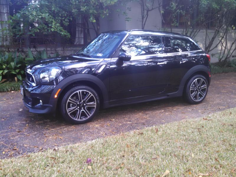

Some quick shots taken this morning, before getting her dirty after the a.m. showers.
Attached Thumbnails First Week Review... '15 Paceman S-2014-12-15-08.25.22.jpg   First Week Review... '15 Paceman S-2014-12-15-08.26.48.jpg   First Week Review... '15 Paceman S-2014-12-15-08.27.32.jpg
Looking good. Like those wheels.

+1
Geat looking Paceman...

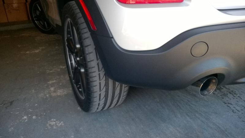

I'm running the OEM 18" 5-Star Double Spoke in Anthracite.
Attached Thumbnails First Week Review... '15 Paceman S-wp_20140121_14_44_03_smart.jpg

Thanks for the info. I was planning on purchasing aftermarket wheels with a 40mm offset. I believe MINI OEM wheels have a 52mm offset for the Paceman/Countryman 18". If this is the case the wheel/tires combination will be located closer to the suspension by 12mm or .472". This may be too close or even hit something.
What brand/model tires did you purchase? Can you measure the overall width and diameter? I need to correlate with Tire Rack's website to see what they have for dimensions online match to what you physically measure. I do not trust Tire Rack's info and want to make sure what they list for your specific tire is accurate to what you measure.
Thanks in advance for your help.

I'm running Bridgestone S-04 Poles and the numbers are correct on tire rack. http://www.tirerack.com/tires/tires....+Pole+Position
It's easy to get the offsets reversed in our heads, because positive is inward and negative is outwards. Meaning you should have 12mm of extra inter clearance with the 40mm vs. the 52mm at the same rim width. You really have clearance for a half inch wider rim (from 7.5 to 8") with the 40mm offset.
This is a great wheel offset calculator, because it shows you the inner clearance and outer position differences between rim widths and offsets. http://www.1010tires.com/Tools/Wheel-Offset-Calculator

Thank you very much for the info and the wheel offset calculator link. Yes it is easy to get the offsets mixed up. After running my wheel width and offset values, I get an extra 4mm or .157" distance from the suspension. Which means I will have even more room than you have between the suspension.
I stated the aftermarket wheel offset I will be purchasing is 40mm it's actually 42mm.
I found a website that sells reconditioned OEM MINI Wheels with all their specs to obtain my OEM wheel offset.
http://www.hubcaphaven.com/mini_wheels.htm

How close are your tires to the suspension? How about when you get full suspension compression and maximum steering turn to lock is there any interference?
I have minimum clearance at all inflation levels on the shock towers in the front, and the same in the back with the suspension fully extended (the closest point of contact on the inside). With regards to steering lock to lock clearance, I have an inch on the outer side corners of the tires from the fender liner. With a half inch wider rim (that's all outward) I'm thinking you should end up with around three quarters of an inch clearance.
Running the numbers on the wheel offset calculator, going from 7.5” width with a 52mm offset to 8” width with a 42mm offset should give you an extra 4mm on the inner clearance (a good thing) and extending your rims 16mm / .63” outward should look great with the 245 45 18's.
Running the numbers on the wheel offset calculator, going from 7.5” width with a 52mm offset to 8” width with a 42mm offset should give you an extra 4mm on the inner clearance (a good thing) and extend you rim 16mm / .63” outward should good great with 245 45 18's.
Thanks for your input. Another bonus, I live close to a Tire Rack distribution center. I can install the tire/wheel on my car in their parking lot just to be on the safe side to see if there are any interferences. If the unfortunate occurs I will not have to pay anything and just give the tire/wheel package back with no cost on my part.
