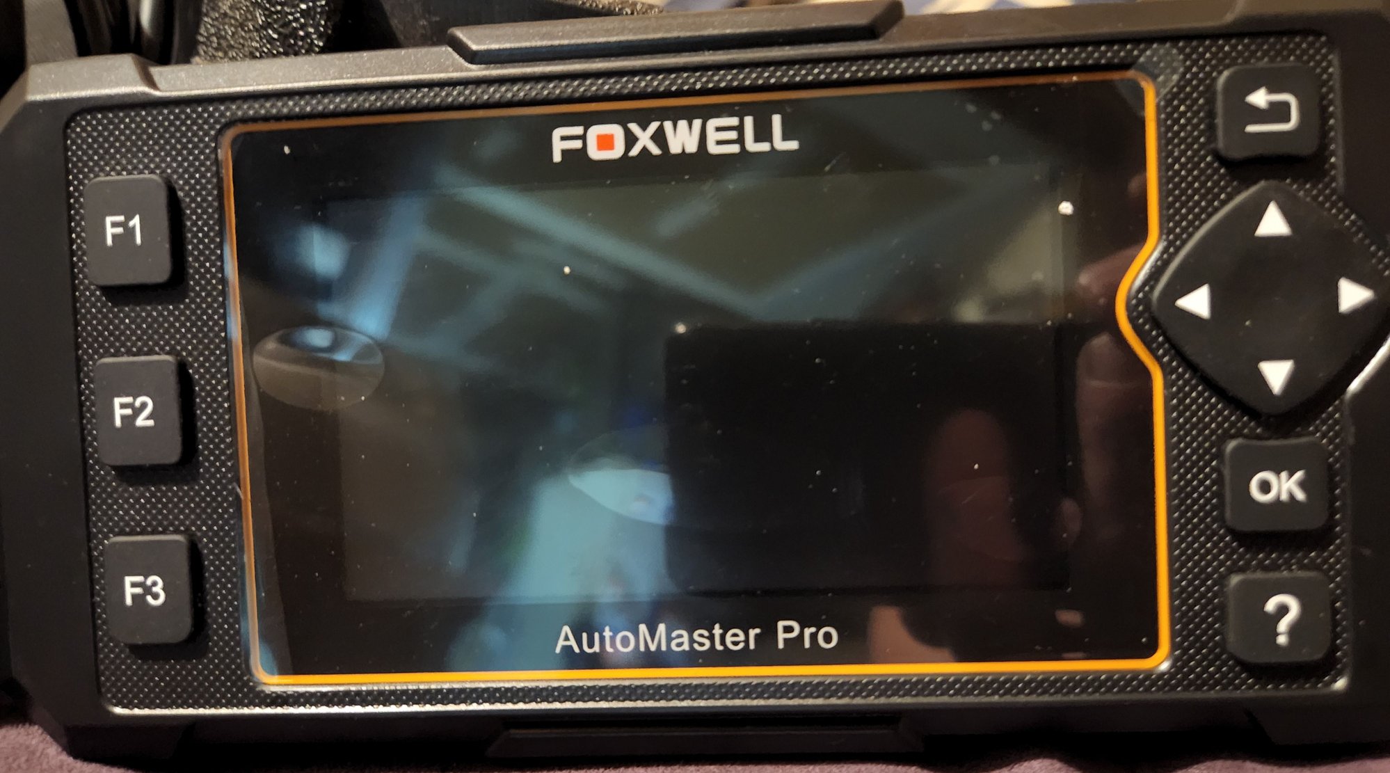

So since it's not saving a DTC and the MIL limp-mode indicator only appears after driving I check the errors when it appears..... but the reader states no fault codes stored.
So thinking it's possibly the reader I'm using as at this time I was using the Bluetooth torque OBDii app. So i repeated the process with two different foxwell readers. Both ran into the same issue. No faults.... But there's a catch, I get no fuel pressure readings on all three devices.
