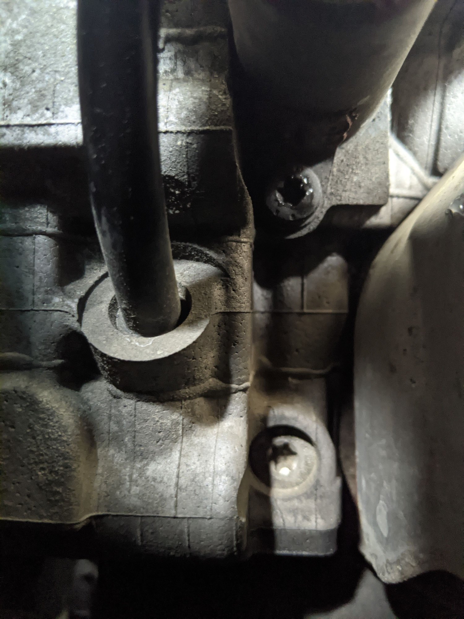

Solenoid valve
I'm having an issue figuring out how to remove the front (exhaust) solenoid valve on my 2011 R60 Countryman base with the N16 engine. Everything I've read starts off by saying to remove the 10mm bolt that holds the valve in place. My has no 10mm bolt that i can see, only a T25 Torx screw. I've removed that screw but that solenoid valve isn't budging and i dont want to break it.....
Old May 24, 2021 | 03:28 AM
njaremka's Avatar
njaremka
Alliance Member
Community Builder
Community Influencer
Joined: Jul 2016
Posts: 7,582
Likes: 2,517
From: WNY
Yeah, that’s the screw. There are O-rings on it to seal, might have to just break those loose. Might have to just wiggle it while pulling out.
Old May 24, 2021 | 11:44 AM
mikey_t's Avatar
mikey_t
Joined: Sep 2013
Posts: 914
Likes: 54
I've tried wiggling and lightly tapping it while doing so but no luck so far. I dont want to break anything (given the cost of MINI parts..) but i may just have to be a little more forceful.
Old May 24, 2021 | 11:46 AM
njaremka's Avatar
njaremka
Alliance Member
Community Builder
Joined: Jul 2016
Posts: 7,582
Likes: 2,517
From: WNY
Once that screw comes out, there isn't anything holding it in. If you have a new one on hand, just yank it out. I have replaced both mine, but I can't recall how much force was needed to pull them out.
Old May 24, 2021 | 06:29 PM
mikey_t's Avatar
mikey_t
Joined: Sep 2013
Posts: 914
Likes: 54
Are the front and back solenoid valves identical?
Old May 25, 2021 | 03:37 AM
njaremka's Avatar
njaremka
Alliance Member
Community Builder
Joined: Jul 2016
Posts: 7,582
Likes: 2,517
From: WNY
Yes
Old May 28, 2021 | 10:35 AM
mikey_t's Avatar
mikey_t
Joined: Sep 2013
Posts: 914
Likes: 54
Got it. Just took a little extra force. Maybe I'll tackle the one on the back side of the engine while I'm feeling lucky ....
