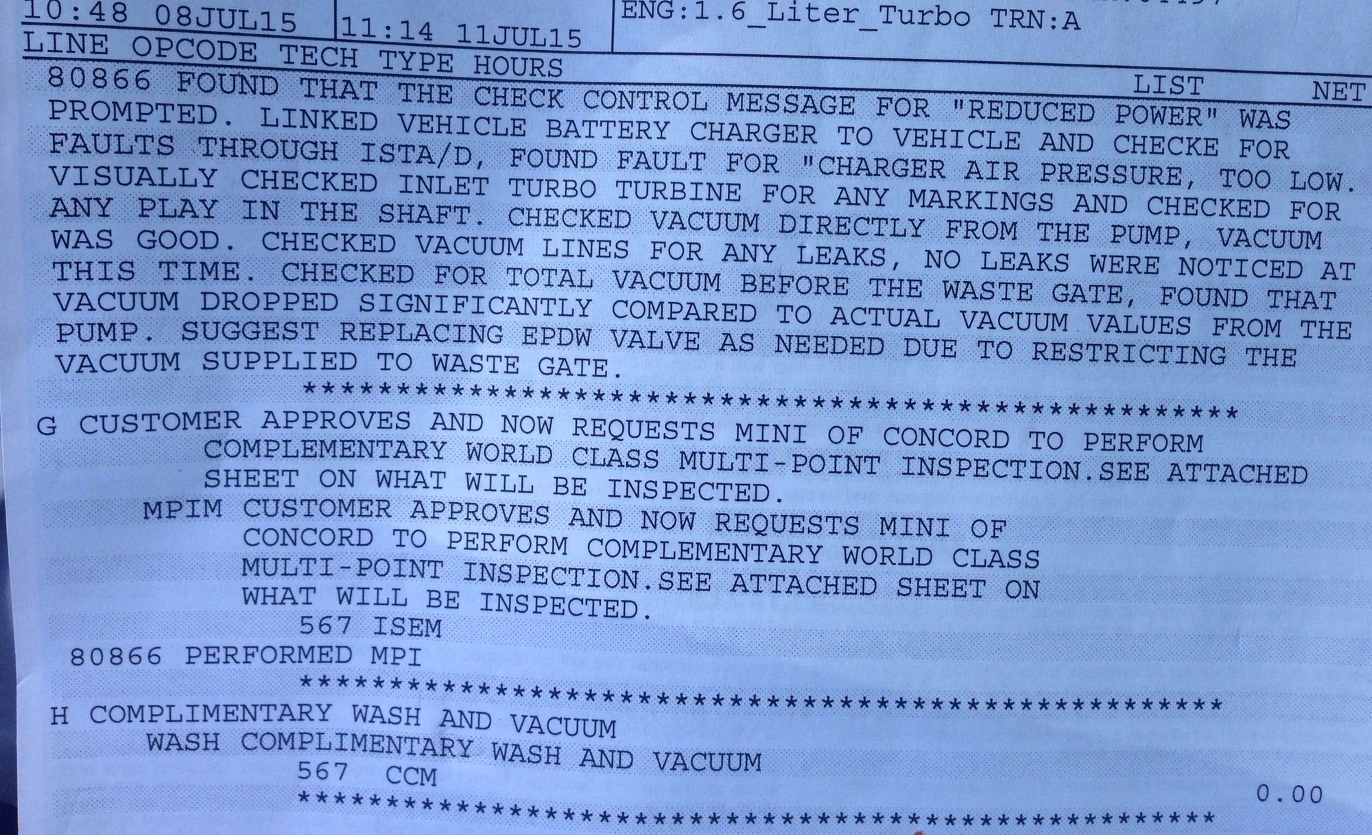

What's the EPDW valve?
Dealership tech was able to identify why my wife's countryman randomly gets a reduced power light. Just curious what that EPDW valve is.
Old Jul 18, 2015 | 07:20 PM
OreoSAll4's Avatar
OreoSAll4
Joined: Dec 2012
Posts: 120
EPDW valve = Pressure Converter PART##11657599547.
