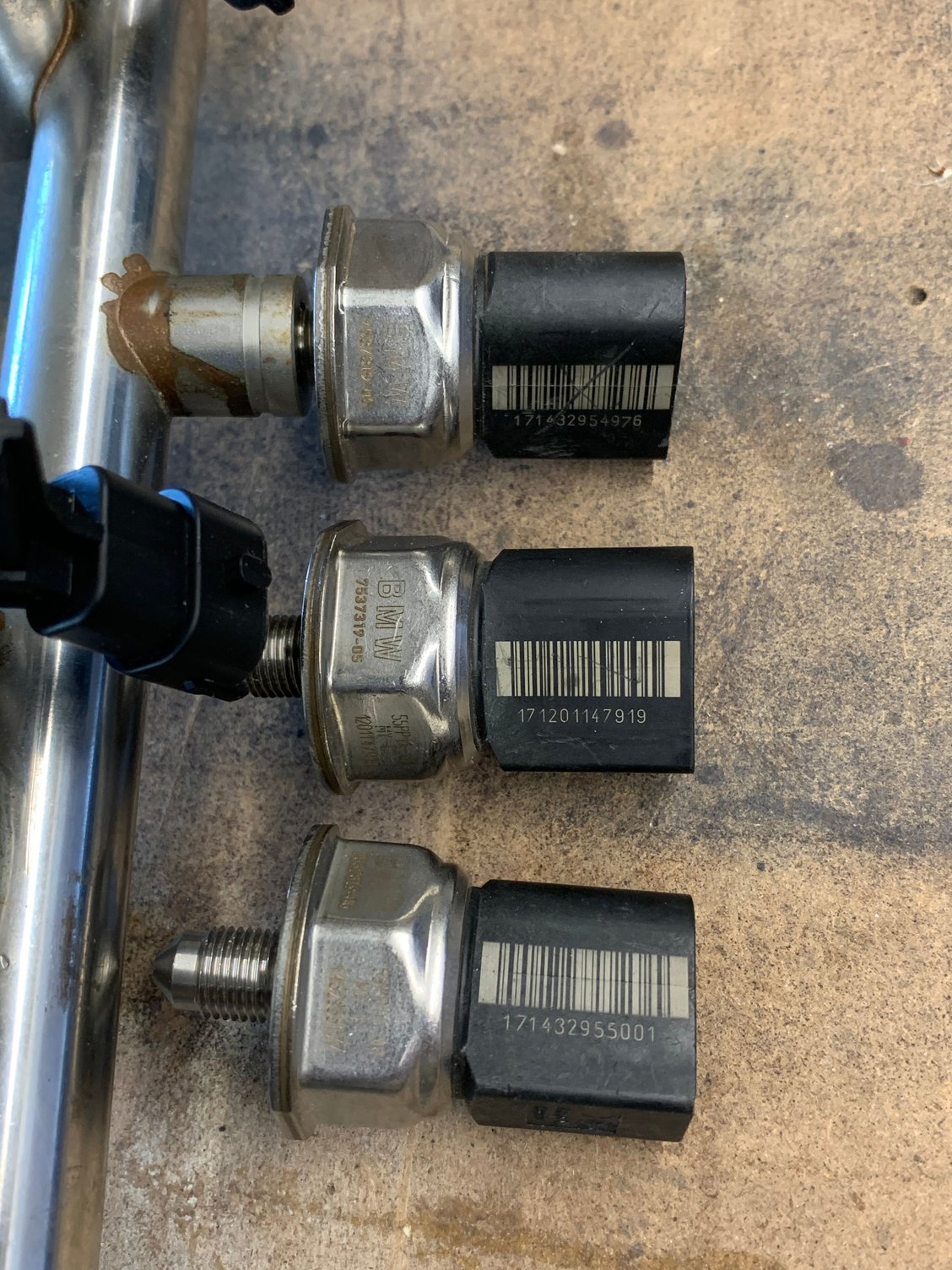

Can I get a break!
DME came in. Flashed. Fuel issue gone BUT now getting Start assist error, DTC error, no AC, no power steering, no tachometer, and the damn OBDII port won’t communicate! Put the original DME back in and just got the original Fuel error like before with OBDII. The donor wasn’t in a collision. I’ll try flashing again, but I think I’m going back to order another one.
UPDATE: Bent Pins. Fixed and P0193 remains. Wires tested & readings are good. Ordered new FPS and will update when I get the results.

IT IS FIXED!!!!!
Thanks to all that helped. The final issue was P0193, bad fuel pressure sensor. I finally found the correct part number and replaced. Immediately fuel pressure reading was normal on my OBDII scanner. So my theory was that when the ground on top back of the valve cover broke and I tried to start the vehicle not only did the DME fry, but the sensor as well. I went through the service manual, but it does not have a schematic of flow through the DME. There is 5V that goes to a few places from the DME, including the Fuel Pressure Sensor, so I think that without ground, it fried out. Thank you to all who have helped me get this thing back up and running! Great community!
