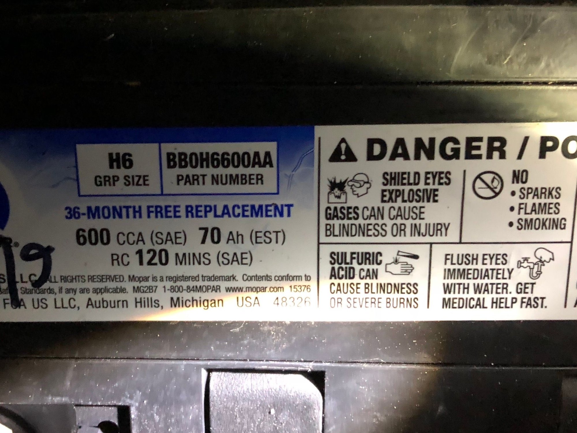

New Battery installed today.
Had a new battery installed and registered at the Chrysler/Jeep/Fiat dealership where I bought my car because I had it there for my free state inspection and they assured me that could properly register the battery. Total - $211.95. Is that a reasonable price? I didn't really have time to shop around and I knew the battery has been on its way out. As far as I know it was the original battery on a my 2012 w/ 40k+ miles.

I guess it depends on what brand and model battery they installed.
Sounds like about $100 less than what a typical MINI dealership would charge.

MINI dealership when offering a special sale price would be more than that. However hard to compare price without knowing what battery they put in. Make sure they put the same size/amps, etc. If not it may require coding as well as registering.

No idea what the original was. This is the new one. It’s a dodge dealership, so Mopar battery.

http://www.realoem.com/bmw/enUS/show...diagId=61_2186
