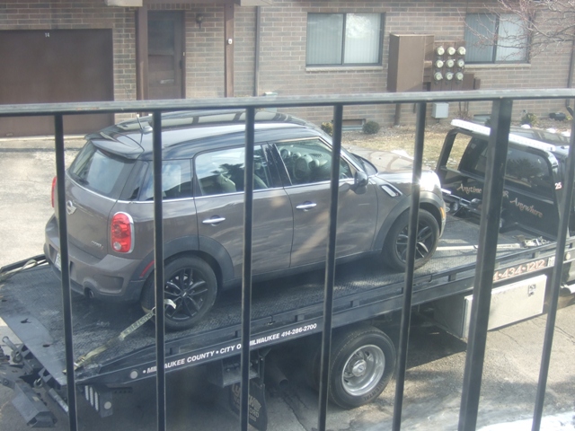

Unhappy Probably the thermostat
Hello all, 1st time poster here.
After my '11 Countryman S did not start this Sunday I felt very comforted after reading this thread.
I've become fairly confident that you can add me to the list for the thermostat issue.
It was about 30 degrees (Fahrenheit) in the garage, the engine turned over, but quickly conked out...repeated this about 5 times, and no go. Had them tow it away this morning.
I will update on what the problem really is.

Smile Update
Yup, it was the thermostat housing unit part #:11-53-7-588-876
with thermostat # 115040 (I think)? that got replaced. Took about 5 hours, and got it back the same day.
I really would love to figure out how to unplug the sensor, just in case I get stranded somewhere rediculous if the thermo breaks again so I can make an attempt to limp somewhere.
