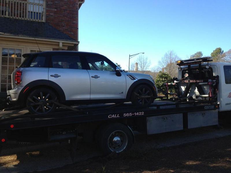

Hello! I've been lurking on here since November when my girlfriend bought a used 2011 CM. Its an ALL4 with most options except for leather and navigation. Had 14000 miles or so, now 17,500 miles.
I hate being that guy who posts with bad news as his first post, so I will start with some positive words.
Where I come from: I daily drive an SVT Focus and have an old Z06. The CM handles well although it seems very stiff. I hear the run flats contribute to this feeling. Power is not bad but you really need to work the engine. I have to remind myself that 1.6 liters is still 25% smaller than my SVTF. The interior is best of the 3 cars I get to drive regularly. I hate to say it, but I really like the car!
I would really like to test drive a standard Mini or even a JCW. I like to think my SVTF could hold its own in the corners.
Ok - spent the weekend in Williamsburg, VA. It was cold, but not much colder than Maryland. During the 3 day trip the car had 1 start up that had a small hesitation. GF says it would sometimes do that in the mornings when cold. Also said 1 time it didn't start on the first push since she bought it.
Sunday morning came and it would not start. I got a battery charger so I tried and tried but could not get it to fire up.
Had to hit the starter to get the car into Neutral, so we could push it to the tow truck. Long story. Anywho, 60 mile tow to Richmond and now we wait.

Old Jan 16, 2012 | 06:28 PM
  #46
Rayrevolver's Avatar
Rayrevolver
Joined: Jan 2012
Posts: 8
From: Tall Timbers, MD
Dealer took about 6 hours to swap out the thermostat today. Quick work and good overall experience from Richmond, VA dealership. 2011 CM All4 - 17504 miles.
