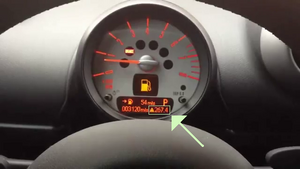

Any idea on how to get it to reappear? Absent minded me, I dont think I ever saw it display for me.. I guess I was too preoccupied with the rest of the car

Thanks for the reply, I'm aware of those options. My question should have been more specific. I do not have the trip odometer in the bottom right of the display under the digital spedo. This is a snapshot of rockets21's spedo and he has the "267.4" whereas I do not. Is this a mod or standard display?

It's gone for good!
Hey guys - here's the poop...
All new 2012 MINIs will have the trip odometer re-positioned so that you must cycle thru the options with your left stalk controller to see it.
All older MINIs that require re-programming will have their version brought up to the current version that re-positions the odometer.
Reason? MINI/BMW wants to reserve that bottom right corner space for informational or alert messages.
See attached PDF I was given from my dealer. I brought mine in for a spot/rally light install, and the required re-programming had this effect on my car.

After the new update my odometer also moved to upper left side, you can see it when you scroll from BC switch.

No, but you can code it to have the trip odometer to the right of the odometer like before. There is a coding thread in the electrical mod section.

yeah im the guy that figured out the coding to bring the odometer back. i posted how to do it in the R60 Specific guide..

And I have u to thank for that. It was annoying having to scroll through the top menu to see the trip odometer. I also hated how mini locked the speed to the square led panel, had to code that sucker out too.
