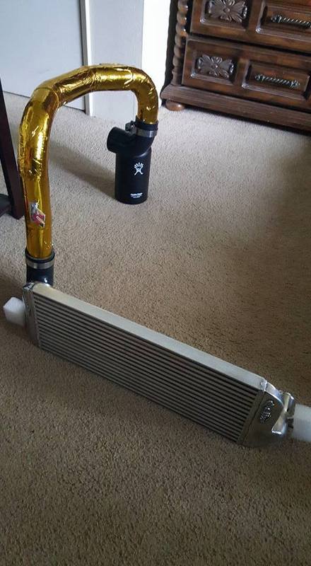

I made my own hot-side pipe, just bought some 2" aluminum piping (from that same site) and some couplers. Pretty easy, just takes some time to fit it in right. I don't have a new pic, it's a better version now, but here is the original one.

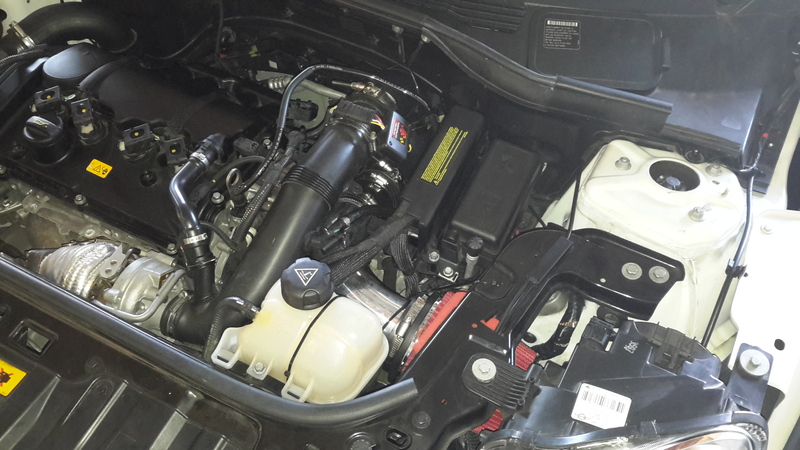

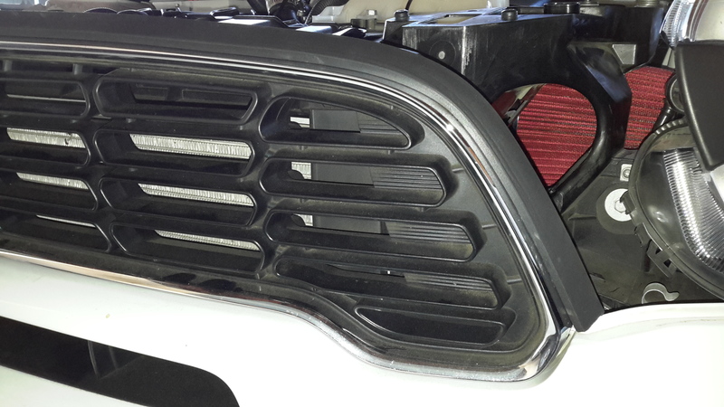

I did create my own cold air intake (needs better heat shielding) with aluminum pipes from that website as well. Cost was easily 1/3, or less, of what aftermarket companies charge and it does the same thing.
