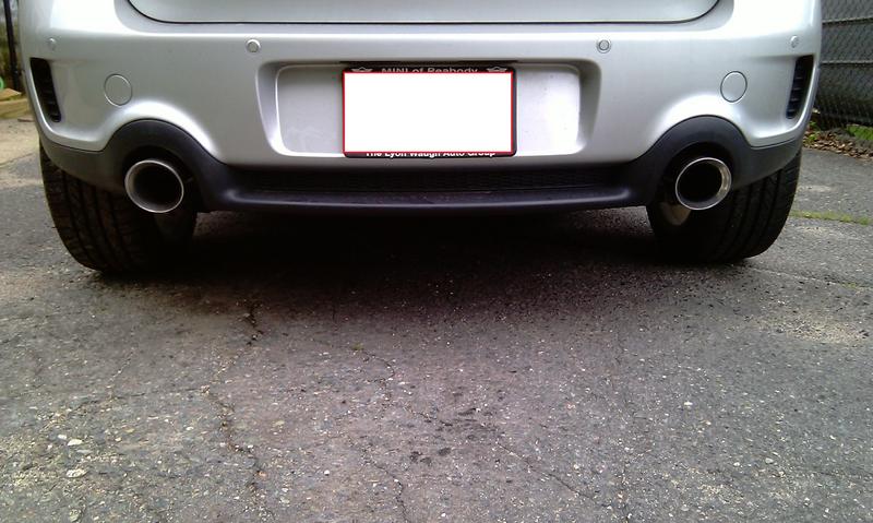

Pretty sure I worked out all the bugs. I had to rotate the bend pipe a small amount and it gave about 1/4" clearance with that cross piece. After 20 minute drive no rattle and sounds great.
opted for the tips rotated slightly to show the Milltek logo. I like how it contrasts the bumper.
