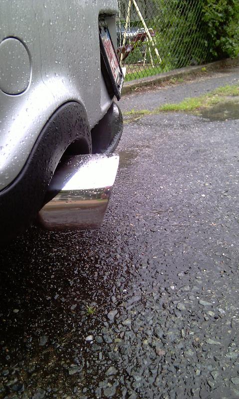

first photo is left pipe from the side view. second photo is the right pipe from the top. And they are not even right now, but after literally 30 minutes of struggling that was best I could do (and it was 9PM at that point)
i missed this post earlier ...
i could get my tips flush with the bumper when viewed from the top
i choose to pull them out a little
scott
