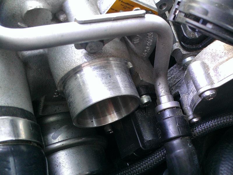

I just installed the Oxspeed BOV spring today. It came with 3 pages of color instructions. The only odd thing about the instructions was they kept saying 'Torx' wrench. The bolts on my 2011 CMSA4 required an Allen, not a Torx wrench. However, you will need a Torx set to remove the air line.
I had bought a folding ball-end allen set for the job, but it was awful and only barely got the bolts out. Even with the air line out of the way there wasn't any room to use it. An L-shaped ball-end set would have been better, but this was all I could find at Home Depot and O'reilly's.
Popping the BOV valve off and installing the spring was easy, but getting the bolts back in with the folding tool was absolutely impossible. I grabbed my regular allen set and an extension for leverage (from my bike tool kit), and I was back in business. After that, I only had one more problem. A metal line above the BOV cover was preventing the top bolt from lining up, but I was able to bend the line slightly to make room. The short end of the allen had enough leverage to get the bolts started, but the extra leverage from my wrench extension helped finish the job.
I dropped the allen wrench a couple of times, but fished it back up with my magnetic screwdriver. The bottom bolt was easy. I thought the rear bolt would be hard, but putting a light on it helped me see what I was doing.
After it was all torqued down, I reattached the air line and double-checked my work. A short test drive later, and the improvement was noticeable. It's subtle, but the turbo really does spin up faster, which seems to make takeoffs easier.
For $15 shipped, this is a no-brainer.
Pre-install tips:
1. Either a ball-end or regular allen wrench will work fine. If you still want the ball-ended kind, get an L-shaped set.
2. You will need a Torx (star) wrench to move the air line.
3. Get an extension for the short end of the allen wrench.
4. Disconnect both ends of the air line and move it out of the way.
5. Test fit the allen wrench into the top bolt. If the metal line is in the way, slowly and gently bend it up a few millimeters until the wrench clears without rubbing.
