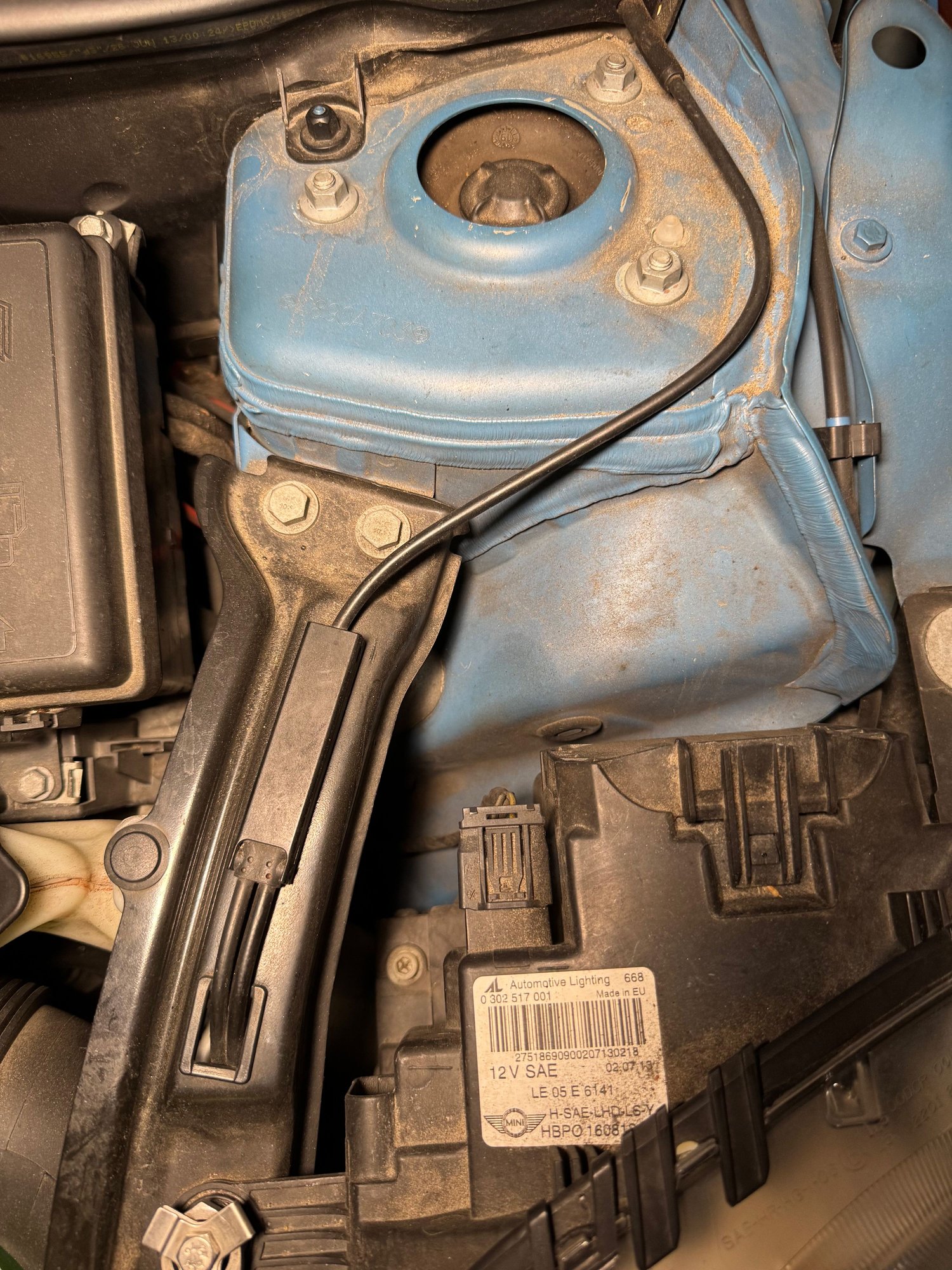

You're unlikely be able to access it through the grill. There are actually two latches. The cable comes from inside the engine bay over the left suspension struts. It connects to a junction box that splits the cable in two separate cables which independently release the latch on both sides. The one to the left (when facing the engine) might be easier to access from under the car. The one to the right is tricky as it is tucked in behind the coolant reservoir.
Here are couple of pictures for you. Hopefully it will help you. 1st picture cable running behind edge. 2nd picture cable split. 3rd picture latch coolant side. 4th picture latch dipstick side.
Not a fun situation to be in...

Here is a picture of the latch itself. I believe the square pin is what releases the rotating latch and the hood loop. It is pulled on both sides from the left to the right by the two cables (when looking at the engine bay).It is not hard to push by hand when the hood is open. Little spring force.
When the hood loop engages it pushes a rotating hook against a spring. The square pin highlighted below is an interference point preventing the rotating hook to move once engaged.

And I assumed it's the primary hooks that do not work. But in case it's the secondary safety hook here are some additional images. It will show you where the hooks and hook openings are located in respect to the car body. The primary hook release pins are unfortunately pretty high, behind the upper sheet metal edge. Not exactly being the grill. There is plastic, then metal, and plastic again behind the metal. Good luck and report how you managed to do it. I don't know how I would approach this if any of these cables got loose.
