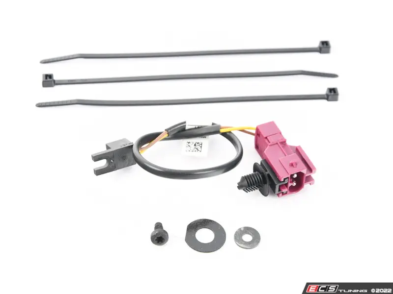

Yep might be the hall sensor. Here is the repair kit:
https://www.ecstuning.com/Search/Sit...h/54342759410/
Thats the manual version.

@ECS Tuning thanks for the lead. I suspected it was this part, but the issue I am having is how do I reach this part. Today I found a switch on the driver side, but haven't located any switch on the passenger side. I am suspecting I've been reading UK threads perhaps(?).
