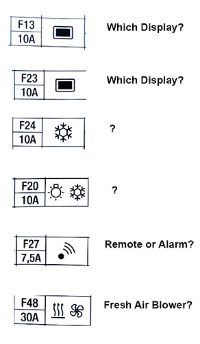

R59 I need info on these fuse pictograms

The manual does not explain fuse pictograms at all. Most of the pictograms are pretty obvious but a few leave me wondering. Could someone please fill me in?

I don't know for sure but I think F24 and F20 show a snow flake so might be air conditioning. Only thing is the amperage is only 10A seems low to me.

I agree. They could provide more explanation of the pictograms. If I recall correctly the last time I did a google image search to find some diagram that explained it...

Looking at my Bentley Manual
F13 > Digital Tuner, Nav, Sat, and video module
F23 > Central Info display, Mini Joystick, and Radio
F24 > A/C Compressor clutch
F20 > Glove Compartiment light, Heating and A/C
F27 > Anti theft, and tilt sensor
F48 > Blower, and Heating and A/C

Thanks, TG!
