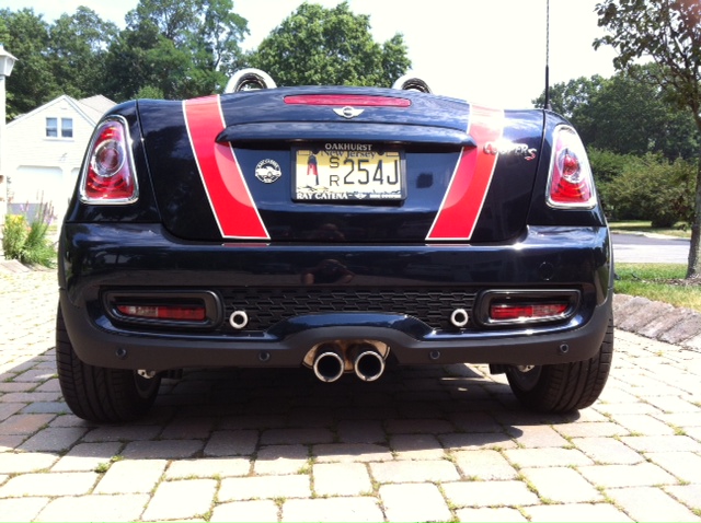

The MINI FINI link system only drills two holes through the bumper, but it actually looks cool. No deformation, though. On a Justa, it looks like a dual exhaust.
Go to MINIFini.com

Does any of these solution have the trailer hitch receiver tubing sticking out of the bumper when nothing is attached to it?
I really want to keep the car free of trailer hitch hardware when not in use... I'd be willing the cut the bumper out if I can make a plug out of it so to minimize modification when not in use but if the trailer hitch receiver section permanently sticks out that would be a problem for me. This is for an MCS.
Old Mar 2, 2014 | 08:32 AM
RodSpindler's Avatar
RodSpindler
Joined: Oct 2012
Posts: 142
From: Salt Lake City, UT
The Mini FINI link system leaves no hitch. You can have the two connectors uncovered so it looks like two exhaust pipes, or put the black plastic caps on. They are flush with the bumper surface, so it looks nice!
