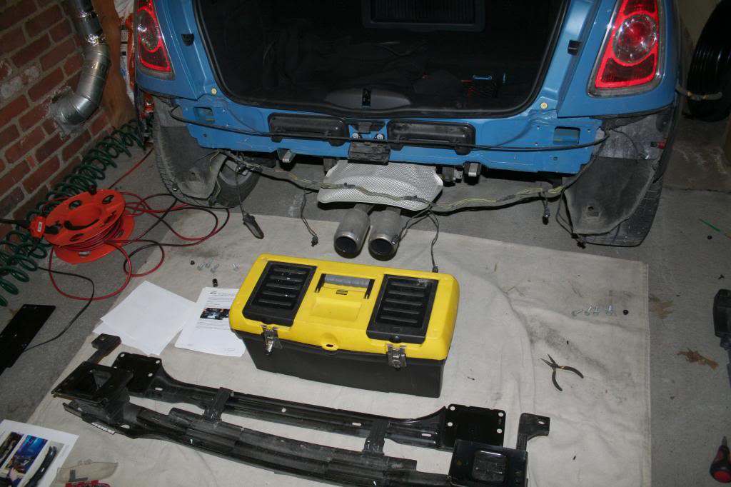

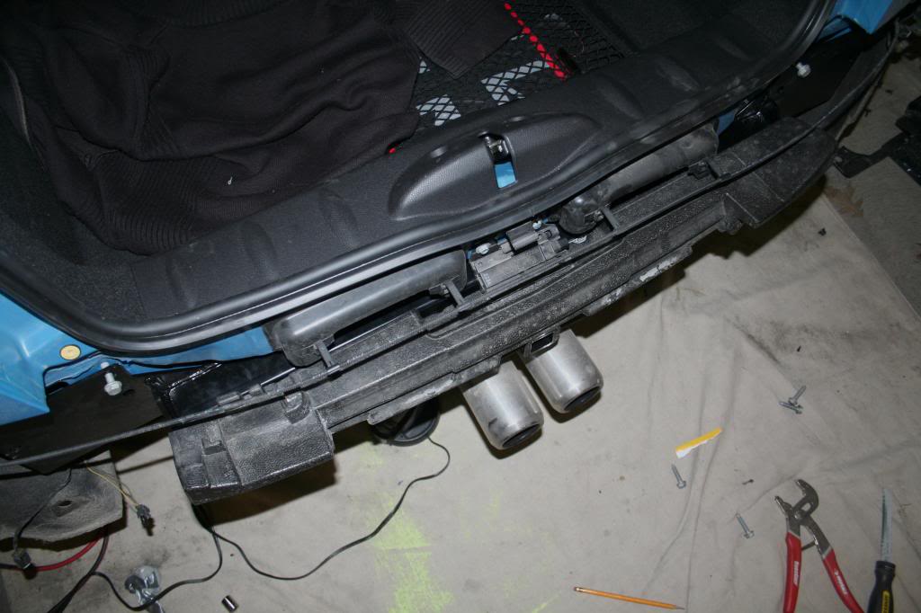

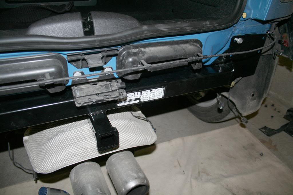

Okay the hitch receiver is on the roadster tonight but I couldn't finish because I didn't have what I needed on hand to cut the bumper metal which is quite thick, and I didn't want to wake my neighbor's kid
, so I'll have to remove the external bumper again... at least the next time will be faster now that I know what to do.
And boy those plastic snaps drove me crazy
. I have 3 to replace now...

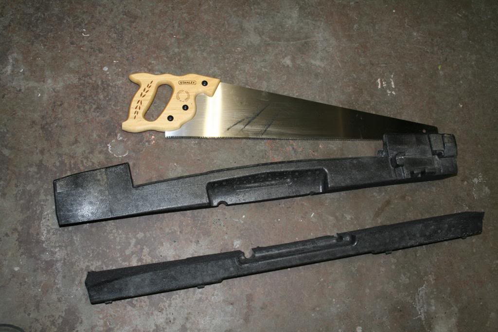

I also decided to keep the foam liner instead of disregarding it. I simply cut it with a wood saw. It was easy and keeps some of the electronic component where they where
I was also very happy that the formed steel plate to remove is heavy enough that the hitch receiver isn't that much more weight added. Yeah!!!!
I'm going to weight it later to see what is my added weight from the hitch install.
Here's a few:
, so I'll have to remove the external bumper again... at least the next time will be faster now that I know what to do.And boy those plastic snaps drove me crazy
. I have 3 to replace now...I also decided to keep the foam liner instead of disregarding it. I simply cut it with a wood saw. It was easy and keeps some of the electronic component where they where
Here's a few:
Ours is the non-S roadster, so it's somewhat different. No metal cutting involved. But, looks like it will be easier to have operating backup lights for you! Overall, I am very pleased. The big picture was completed yesterday when the hitch clamp arrived. We installed it between the outmotoring hitch receptor and the Curt 1-1/4" extension. All wobble and rattle eliminated! If you are in a scenario like mine where you require an extension, I highly recommend the Hitch Rider. 30 bucks plus shipping, well worth the extra few dollars.
Yes, no light modification needed on the S.
I'll probably need that clamp considering I hate rattles
It's odd that they used a different bumper structure between Justa and S...
Maybe so, TG. But I'm thinking that it was a matter of necessity when they added the S models, given the location difference with the exhaust manifolds. We will just leave the extension attached, so no need for a cover for the old backup/fog lights unit. I'll post a picture shortly…
