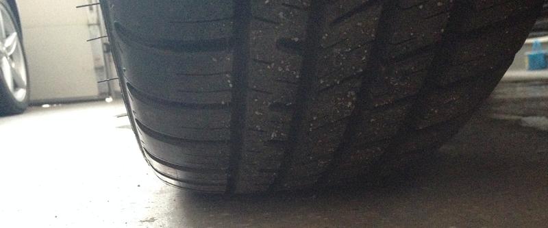

I now have a set of Michelin Pilot Sport A/S 3, 215/40ZR/18's. I have a question. I used the MNI recommended tier pressure settings: Front and Back: 39psi
My question is: Are these pressure settings applicable to non run flats? When I look at the rear tire, a good 2 to 2.5 cm of the outer edge doesn't touch the pavement. I've attached a photo.
Alan

I wouldn't get overly worried about that. It's not the most effective part of the tire until you turn a corner and the car and tire roll. This is pretty common I think.
Other may have some opinion. 39 is a hair high for me. 35 is common. I inflate mine to 37 for sporty driving but 4 psi isn't much of a difference. you see people inflate in the 40s for auto-crossing but I don't know much about it, just what I've heard. I'll say this: better this then under inflated. That's more of a problem.
But if you want to feel any better deflate one to 35 and see how much it changes. That's an easy way to understand if it is normal or not... I'd bet you won't see much of a difference.
I have pilot super sport on both of our cars and the corner gets used so that's an other sign it's probably alright.

I use a tire pyrometer to measure my tires for proper inflation. Using PSS's in a 215 width and 17 inch rim. I believe I'm running 34.8 PSI in the rear.

I'm going to try 35psi and see the difference between 39psi (posted on the door sticker).
I'll post some photos.

Yes, my car has been garaged so long this winter and now again. It's 33.8 or 34.8 but I think it's 33.8 rear. So I'd try between 34 to 35 for rears and two to three more in front.
