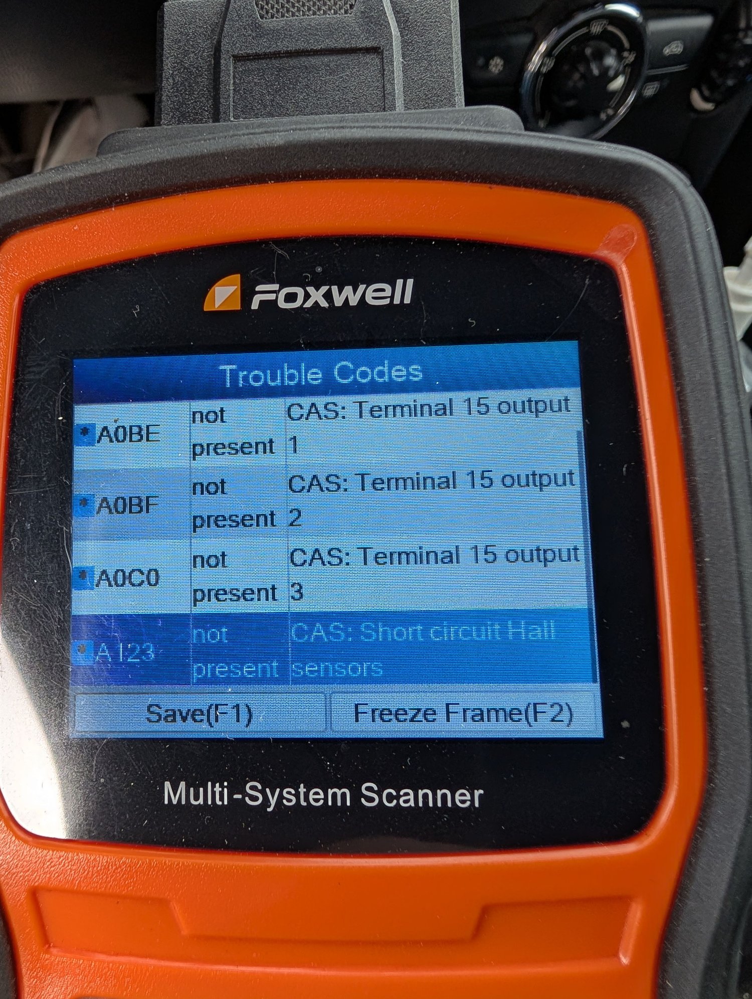

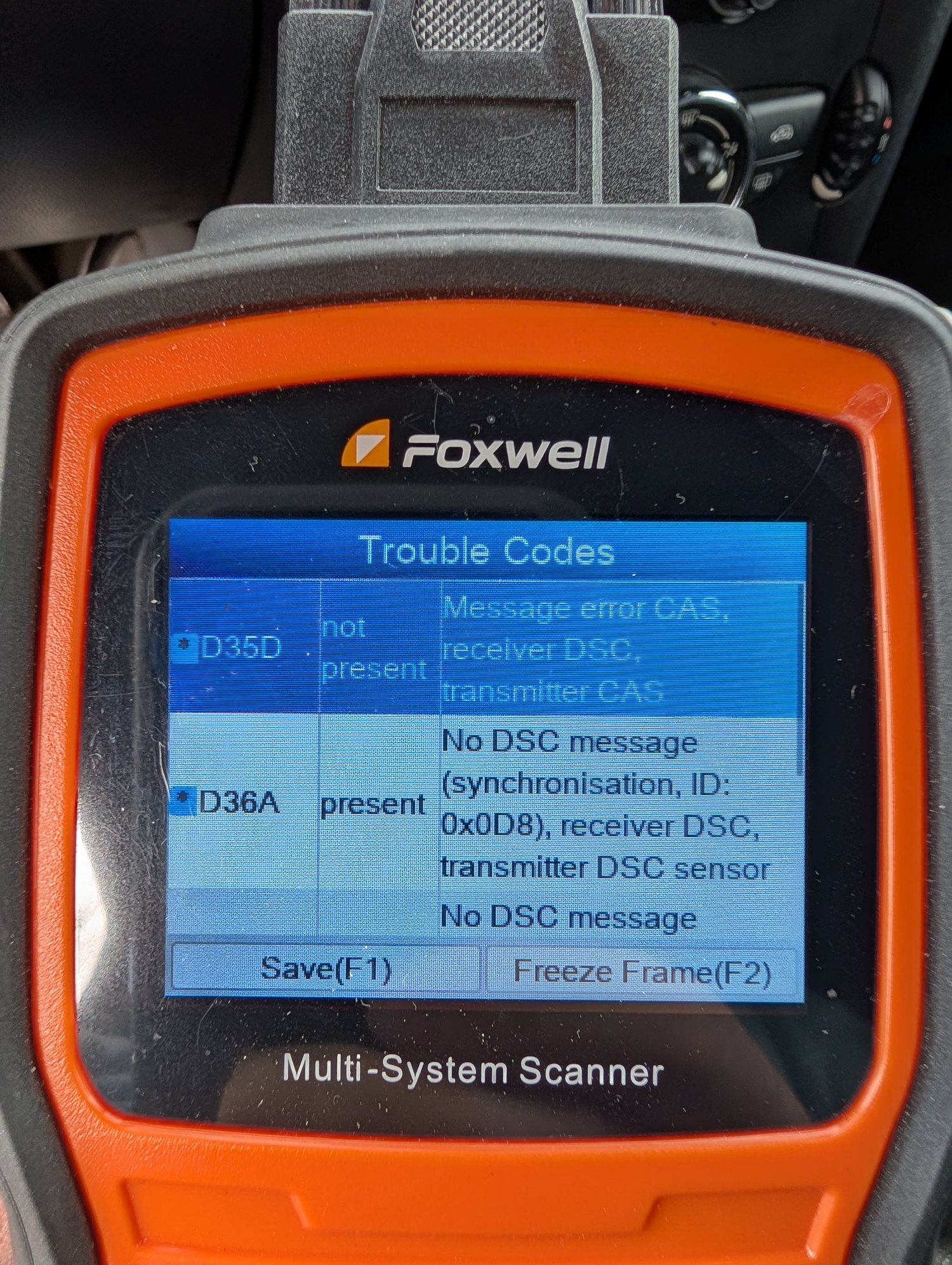

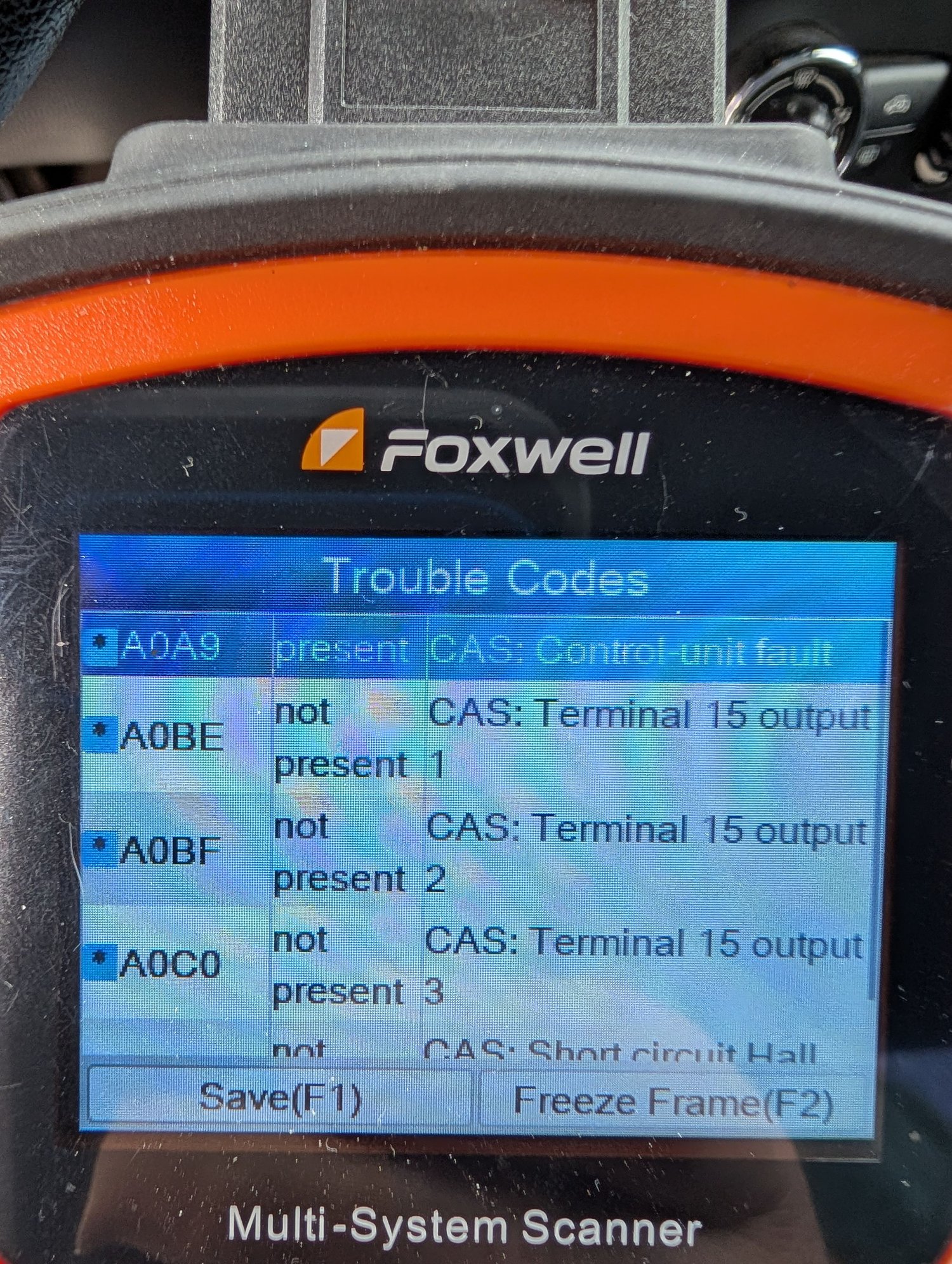

CAS and DSC codes

That's a complex set of fault codes, all of which could potentially be caused by an intermittently failing CAS module.
However, before deciding on any direction to take, first clear all of the fault codes and then turn ON the ignition key without starting the engine to check which codes, if any, return. Post all codes that return after clearing the current ones.

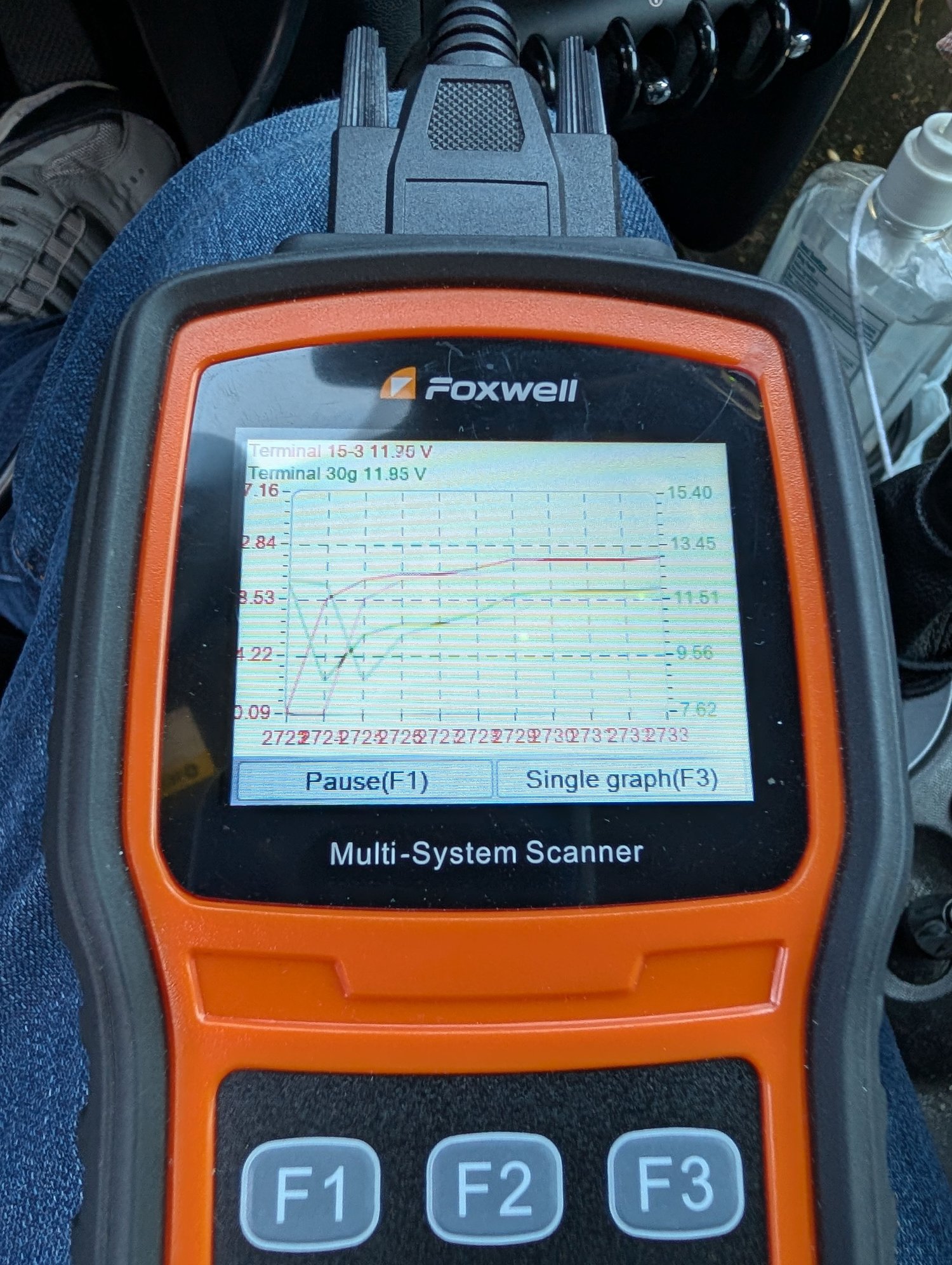

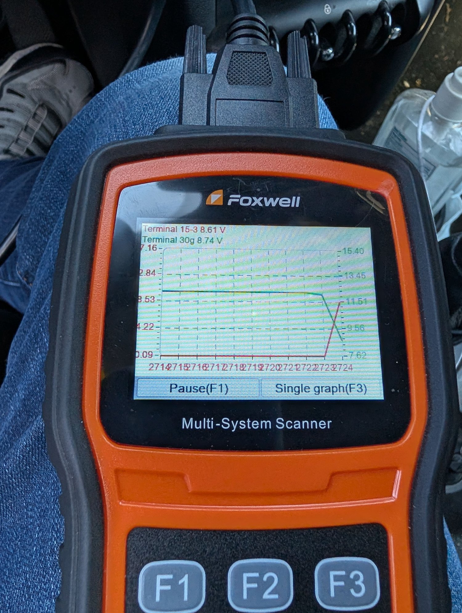

Use your scan tool to graph the CAS module voltages at both terminal 30 and terminal 15 before and after you start cranking the engine. Post your graphs.

Top to bottom = from fob inserted, crank, engine running
Today the car is also intermittently not starting on the first push of the button ... Starter flutters like low voltage, then the car will start after the 3rd or 4th push of the button - battery, again, is brand new and passes load test, yes, it was coded to the car
Interesting.
However, you only mention three conditions above but show 4 images. Please list the four conditions matching the images.
Can I assume that the second image is the initial cranking?

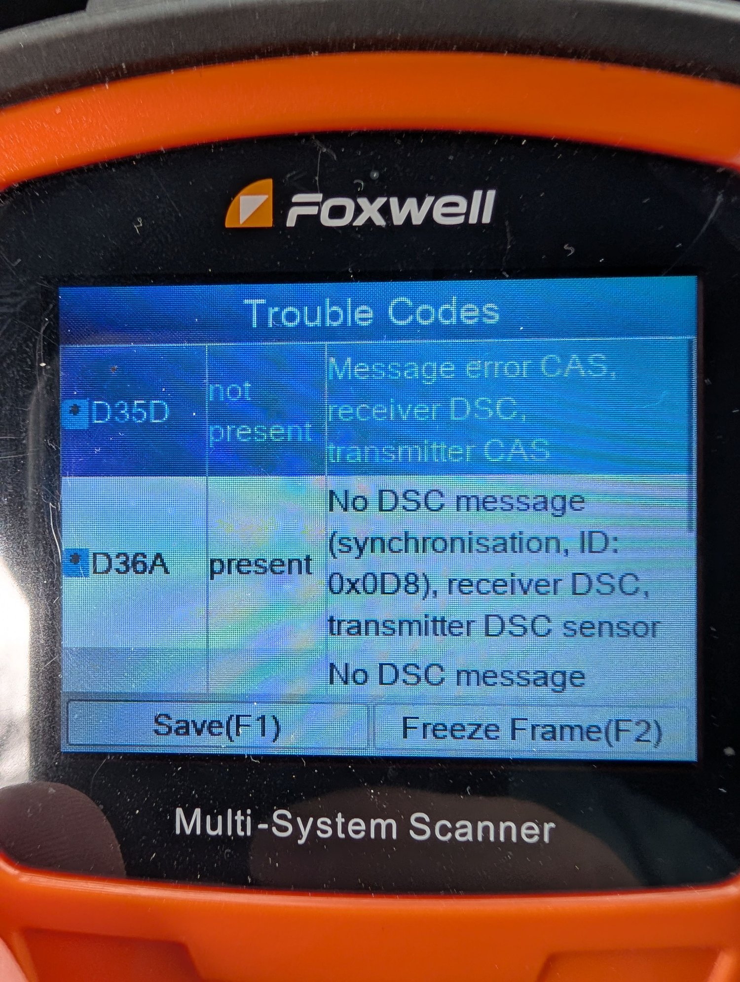

Since I can't post a video, there is a few seconds in photo snaps ... 1 key fob inserted, 2 cranking, 3 continued cranking, 4 engine has started

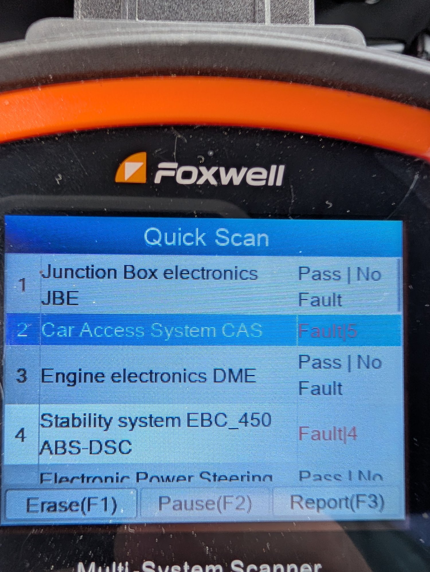

#3, 5 &6 are saying the failure is due to no message from the CAS transmitter
I'm just about convinced that the CAS module has given up

Image #2 reveals the likely underlying issue causing all of the problems. During cranking, the terminal 30 and terminal 15 voltage should not drop below 9.6V. Your voltages drop as low as 8.6V, likely causing the CAS to stop processing (code A0A9), the DSC to reboot, and the JBE to stop receiving voltage from the CAS (code C91E).
Possible causes of the low voltage spike:
1) Excess resistance in the engine ground wire.
2) Excess resistance in a battery-connector to battery post connection.
3) Excess resistance in the battery cable to starter/alternator harness connection.
Old Mar 14, 2026 | 02:26 PM
My interpretation of code C91E is that the excessive voltage drop during cranking prevents the CAS module from communicating with other modules on the CAN-bus.
Another possible cause of the cranking voltage drop is a faulty starter motor that draws excessive amperage.
A simple way to test for a bad engine ground wire is to connect one end of a battery jumper wire to the (-) battery terminal and the other end to a clean, unpainted bolt on the engine block. Then redo the Foxwell voltage drop test.
