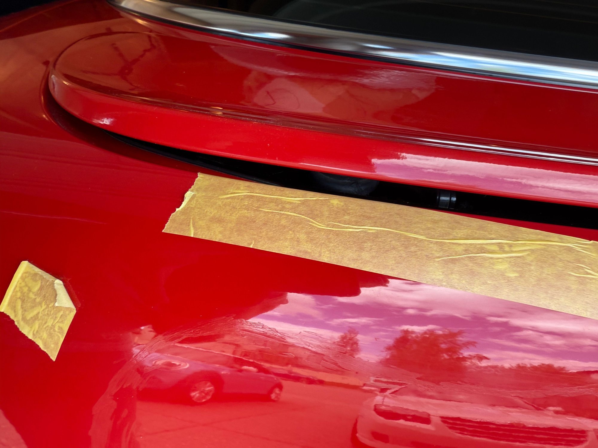

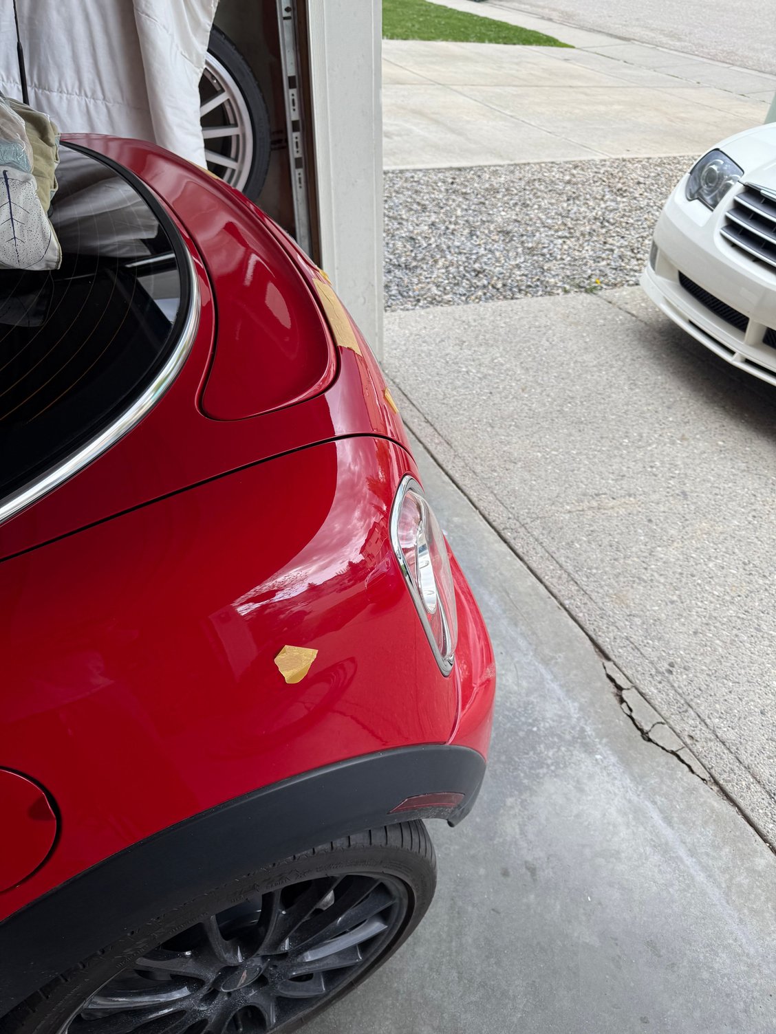

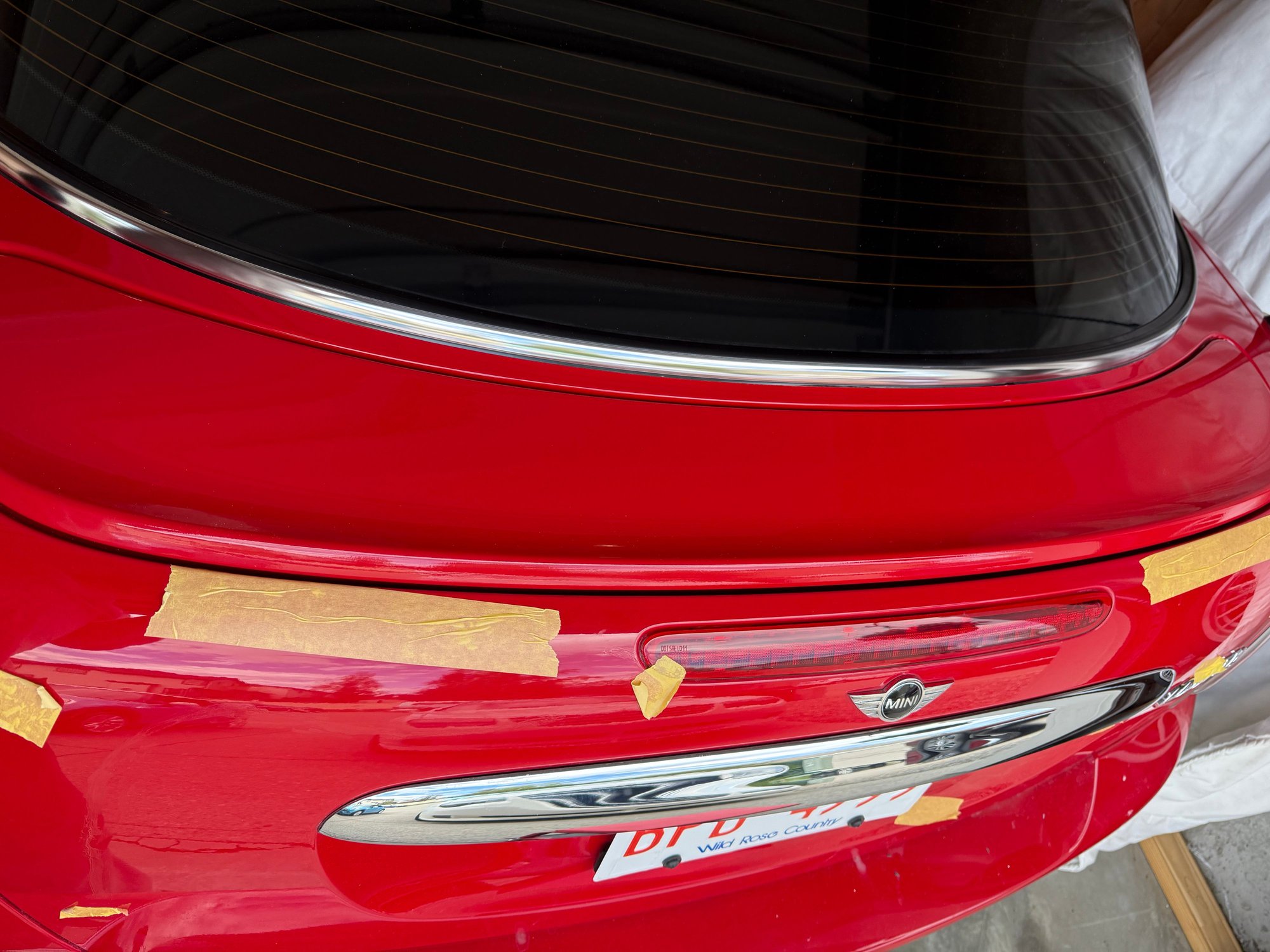

I removed the wing to paint it, completed the project and installed it back on the car
it’s set perfectly
BUT
when it goes up and then back down it will not fully retract to the lowest position
it stays approximately 1cm from the fully closed position. I can push it down and perhaps, in time it will “set itself”
Here’s my question, does the wing have a relearn sequence similar to the reset of the power windows.
I’ve looked everywhere (other forums too) there is very little information regarding the wing. So I’m reaching out for any wisdom that the membership can offer.
Will it “relearn” over time?
I’ve also installed new rubber bumpers on back rear left and right but those do not impact the resting, closed position.
Grateful for any insights.
Retraced with the toggle switch
A bit of pressure and it sets to where it’s supposed to be
