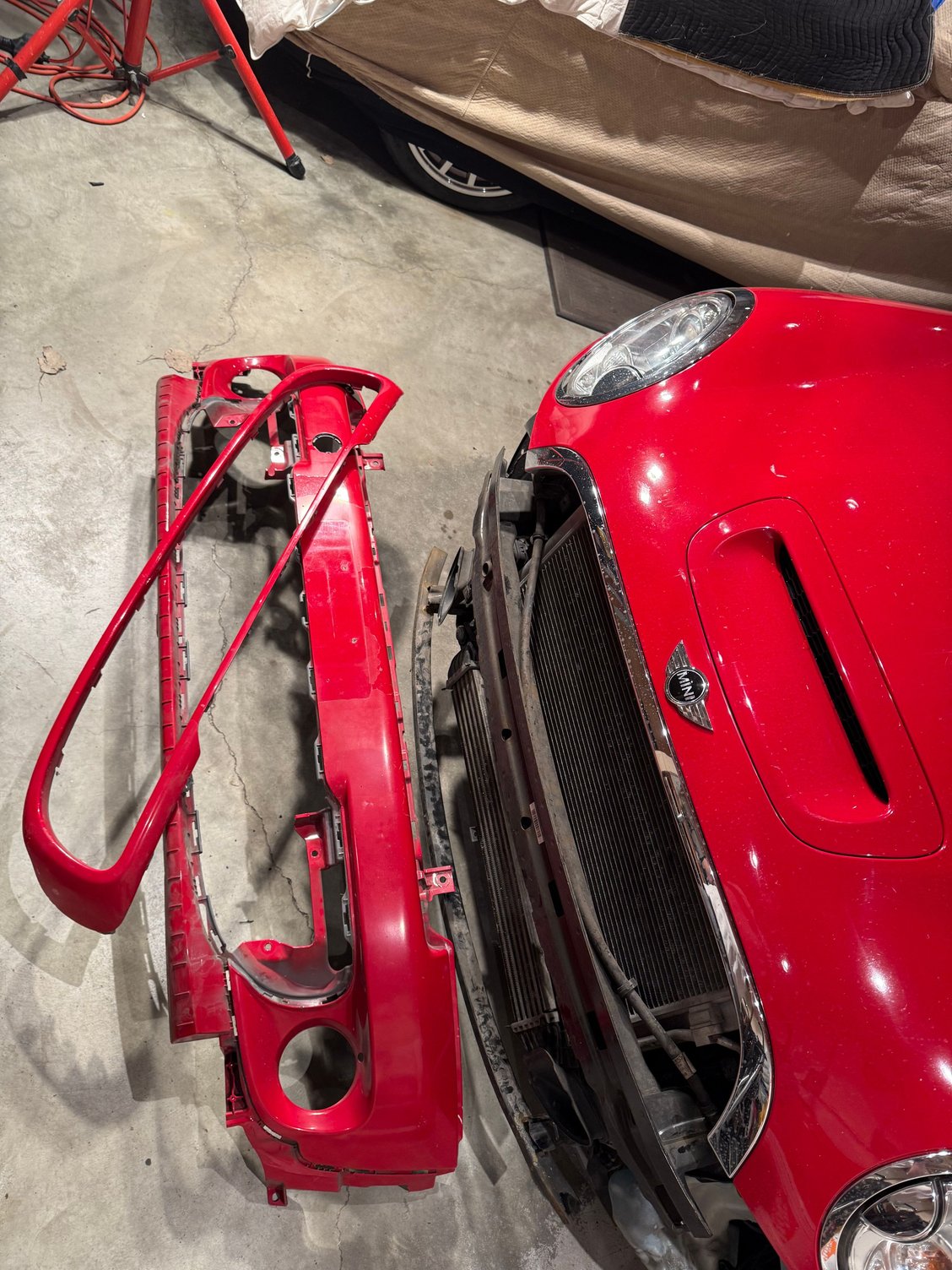

Front bumper cover
I haven’t seen a new post for the R58 since April 1
This is by no means an earth shattering post

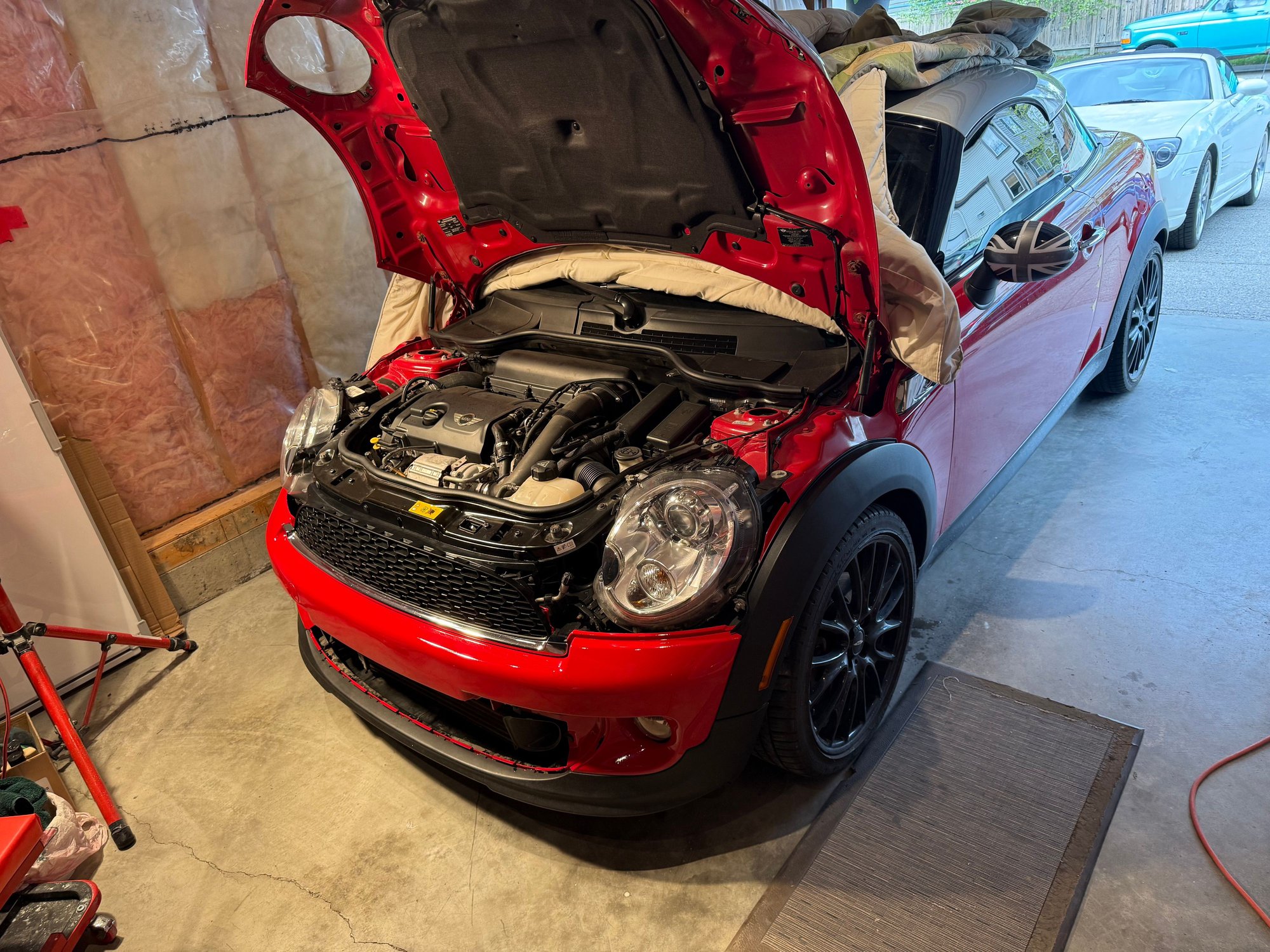

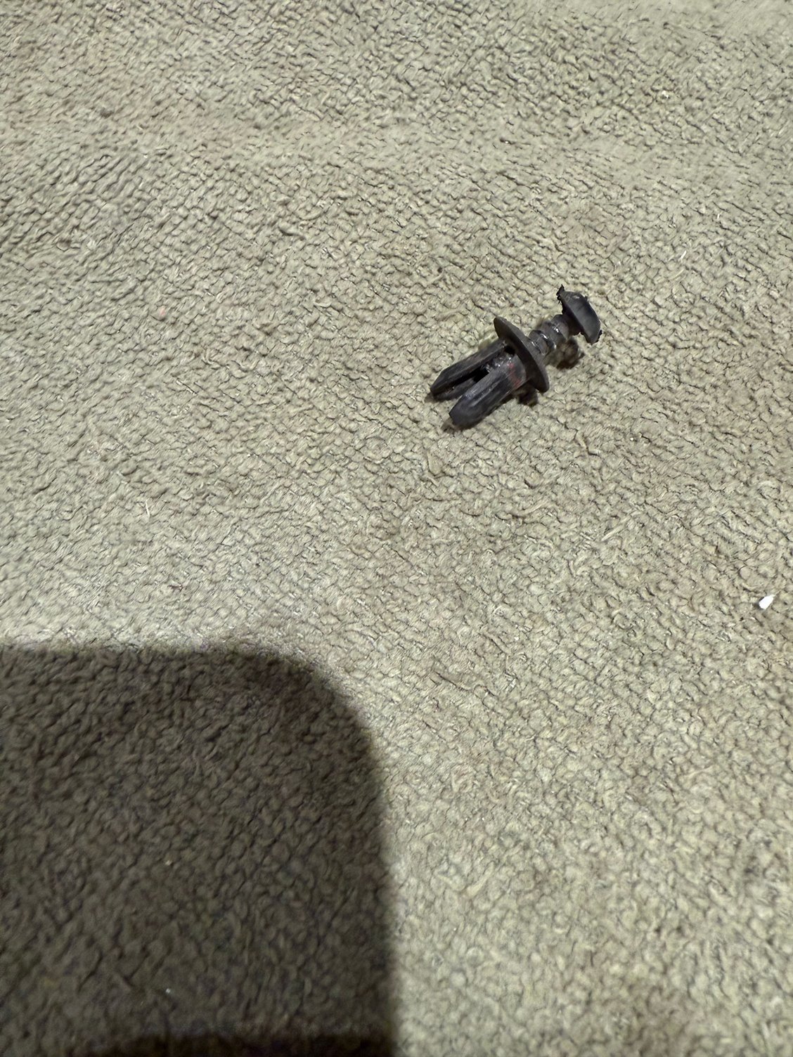

I removed the front bumper cover to repair the holes from the license plate bracket and a previous crappy paint job. The purpose of the post.
I watched many videos, read many posts and reviewed the Bentley manual but I still missed the 3 fasteners under the front chin of the bumper. These were the most difficult to remove.

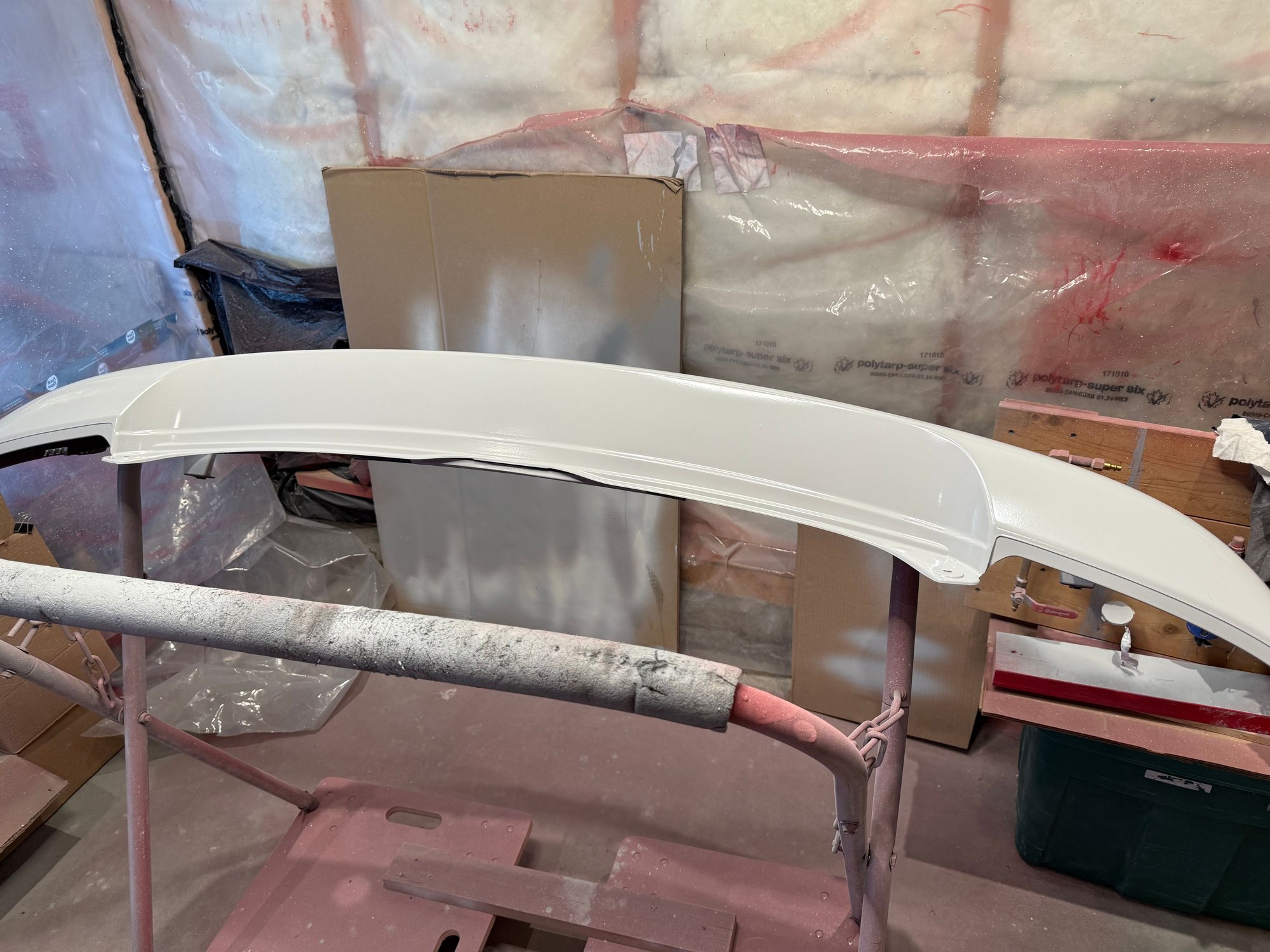

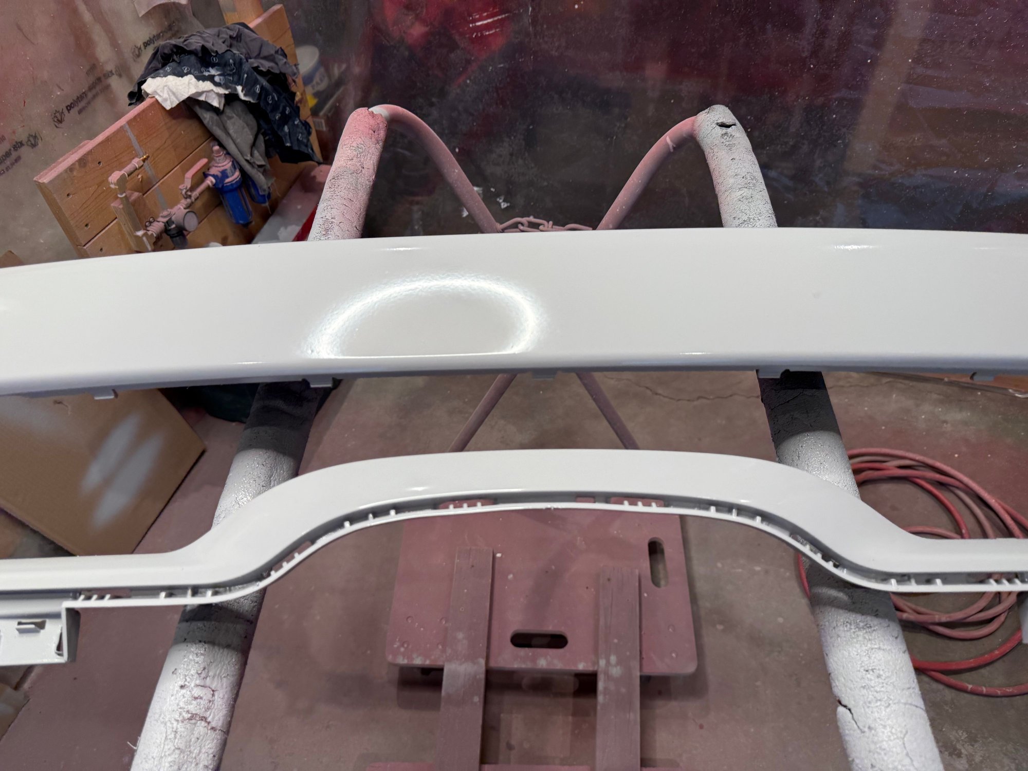

Prepped and primed
With luck and good weather I’ll be able to paint/clear Friday and Sat.
Discovered I was missing one of four rubber bumpers on the speed deployed wing.
nickels and dimes, the project never ends on a 13 year old car. I’ve been unable to locate torque for the wing. If anyone knows it and can share it would be greatly appreciated.

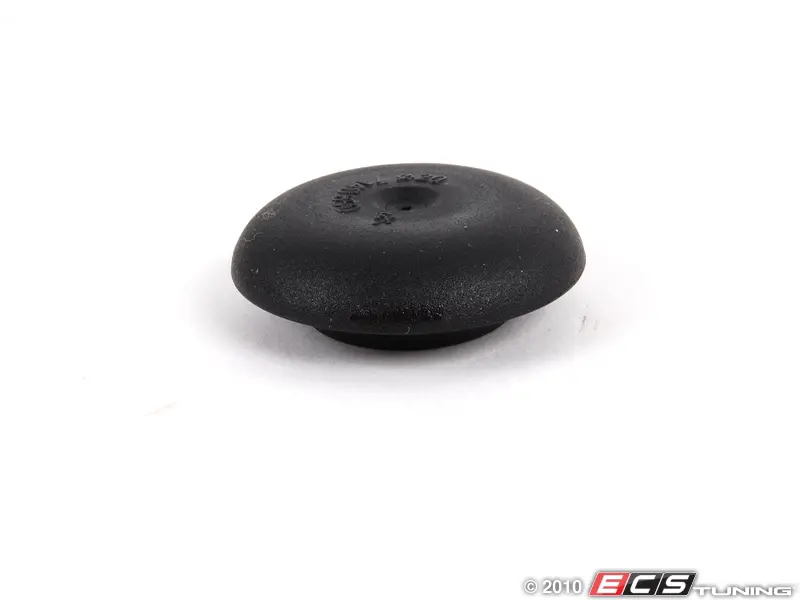

Here is the diagram:
https://www.realoem.com/bmw/enUS/sho...=41_2170Rubber grommet is part of the wing. https://www.ecstuning.com/b-genuine-...r/51627355936/
Space holder https://www.ecstuning.com/b-genuine-...127054471~oem/
I could not find the torque but my guess is hand tight.

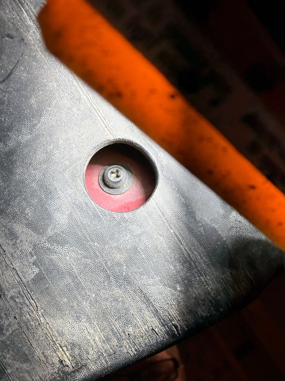

If I read the message in its entirety I would have only needed one post.
I just clicked the link again for the diagrams. Crazy helpful but the fastener for the bottom 3 Phillips head plastic fastener (circled in red are not mentioned on any site
I’ve looked elsewhere to no avail.
They appear to be
51-48-1-95-964
which appear to replace
51-48-0-141-017

Glad to help and thanks for all the kind remarks.
https://www.ecstuning.com/b-genuine-...h/51168197908/
Diagram number 14 https://www.realoem.com/bmw/enUS/sho...diagId=51_7962
I think they were also capped by these:
https://www.ecstuning.com/b-genuine-...h/07147140850/

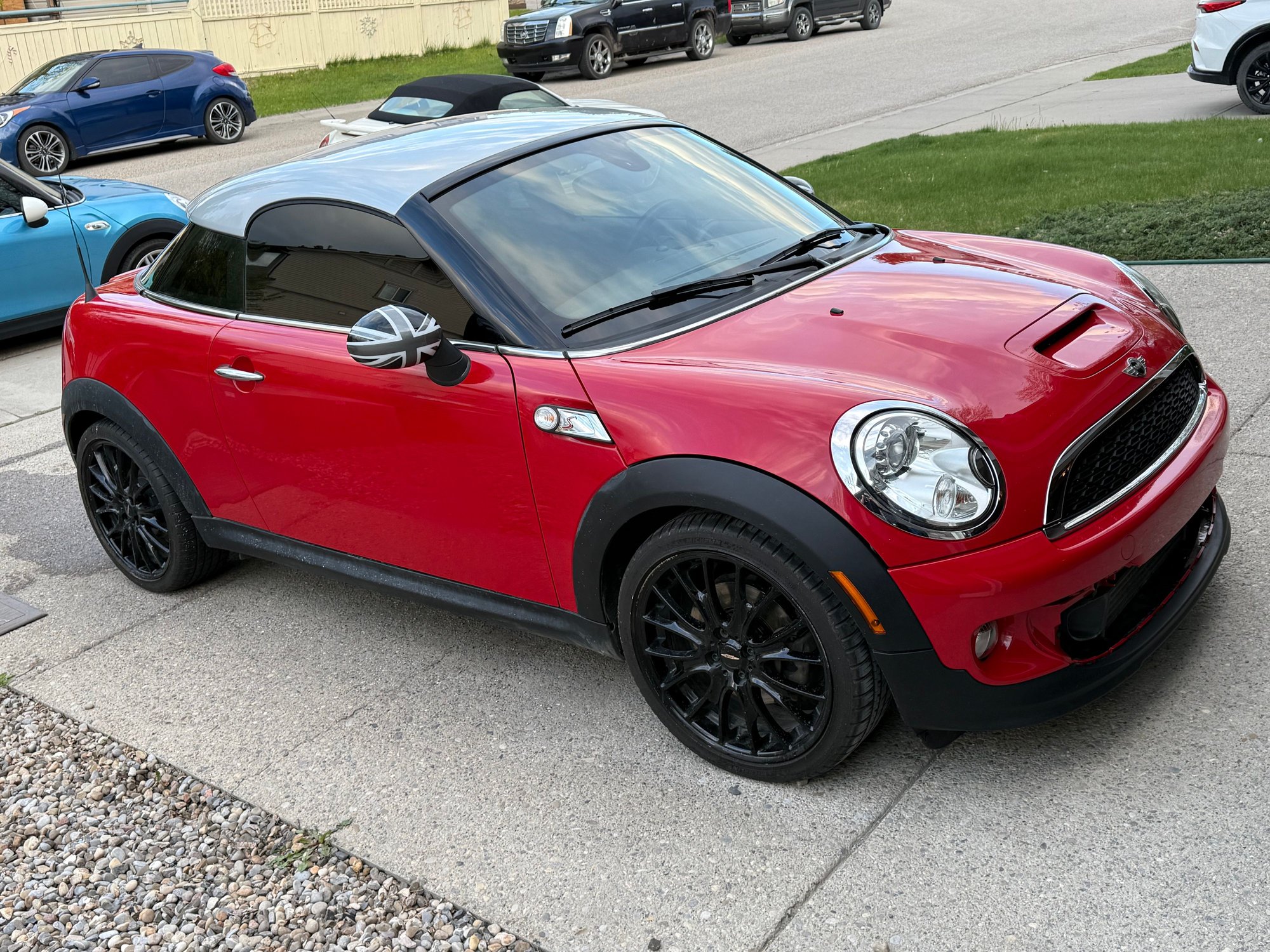

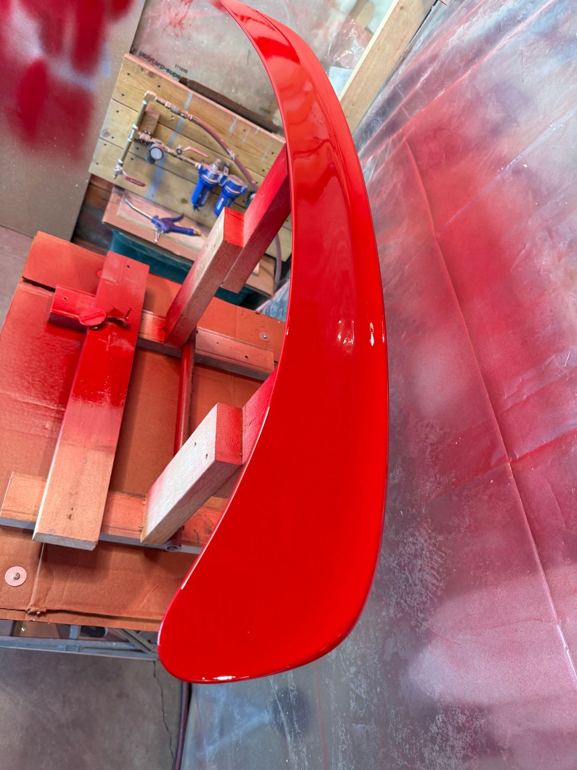

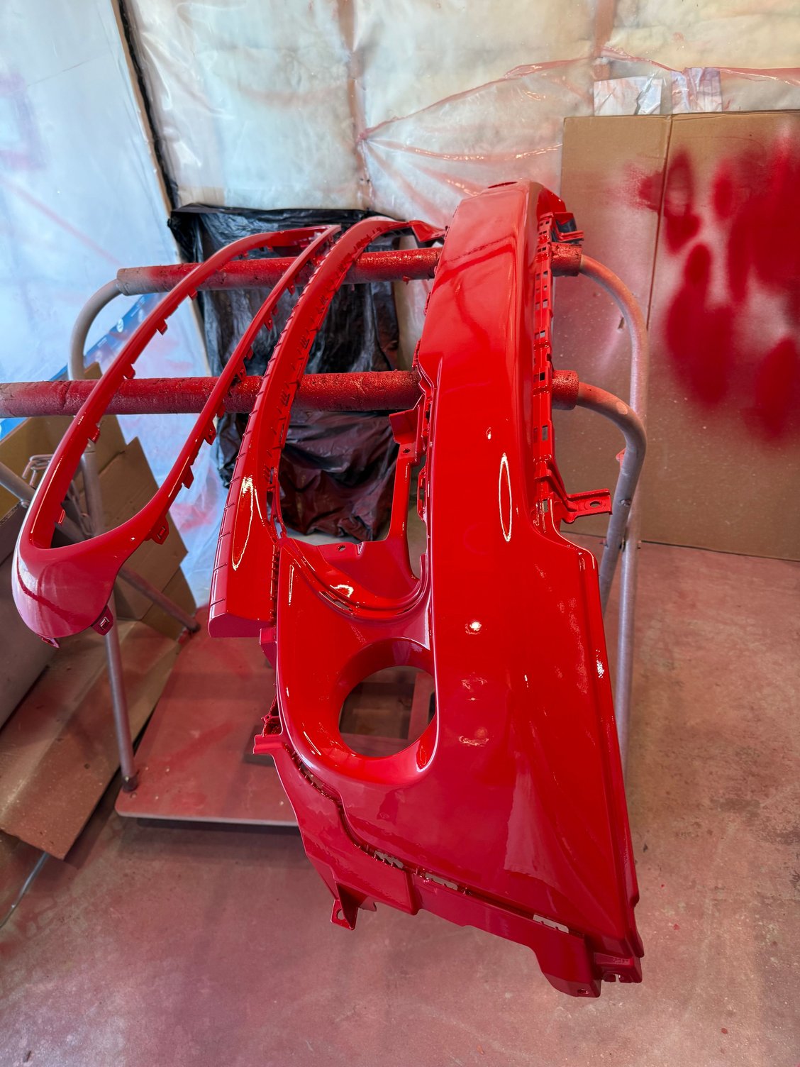

Front bumper and wing are done
Start on rear bumper tomorrow.
If you want to learn to paint at home ask the paint store a million questions and watch a lot of videos, YouTube is your friend.
Happy Saturday

Looks great!

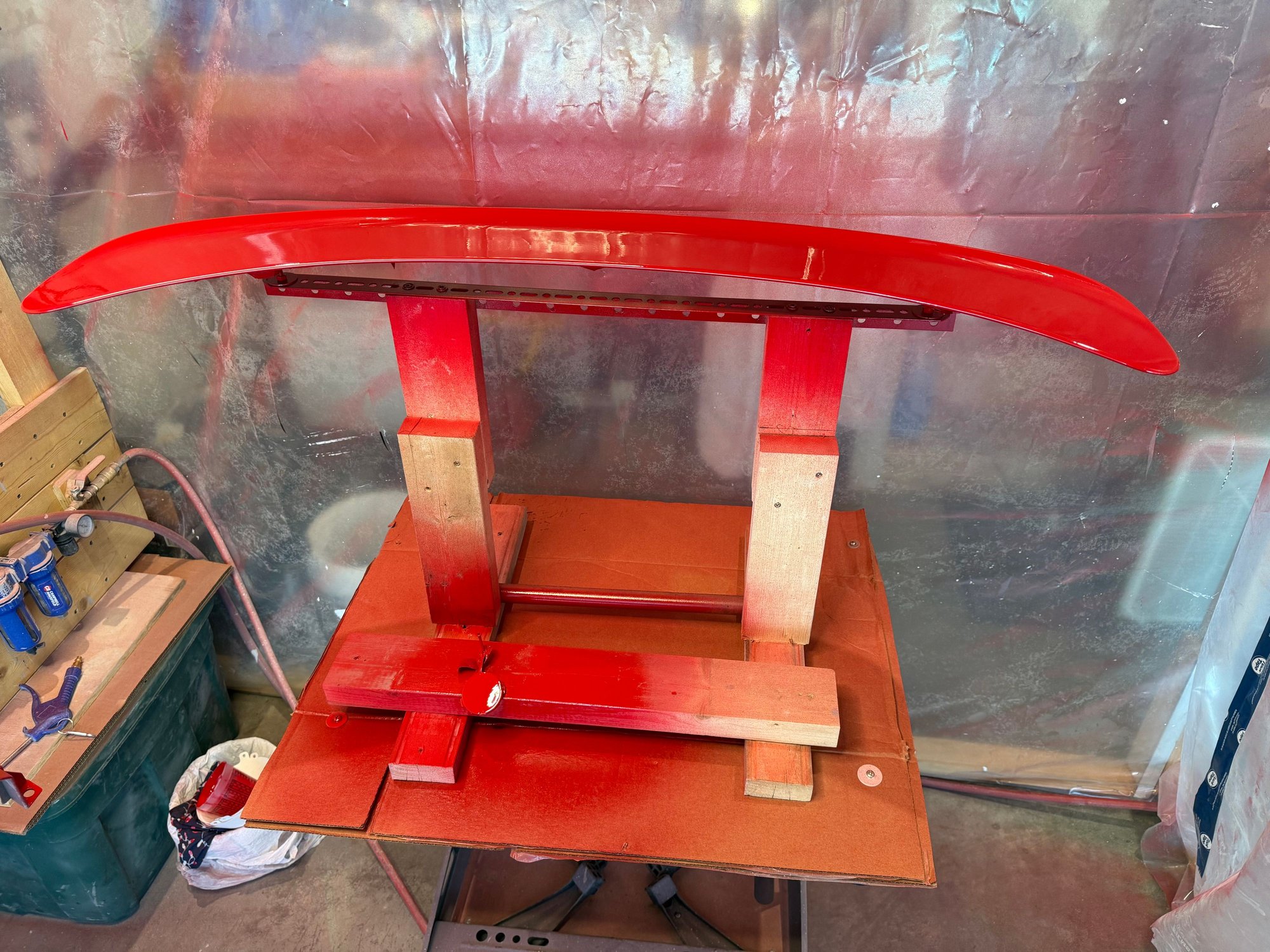

Old May 19, 2025 | 05:52 PM
Velcross's Avatar
Velcross
Joined: Jan 2025
Posts: 96
Likes: 58
From: Canada
Almost done
fitting the wing was a huge production

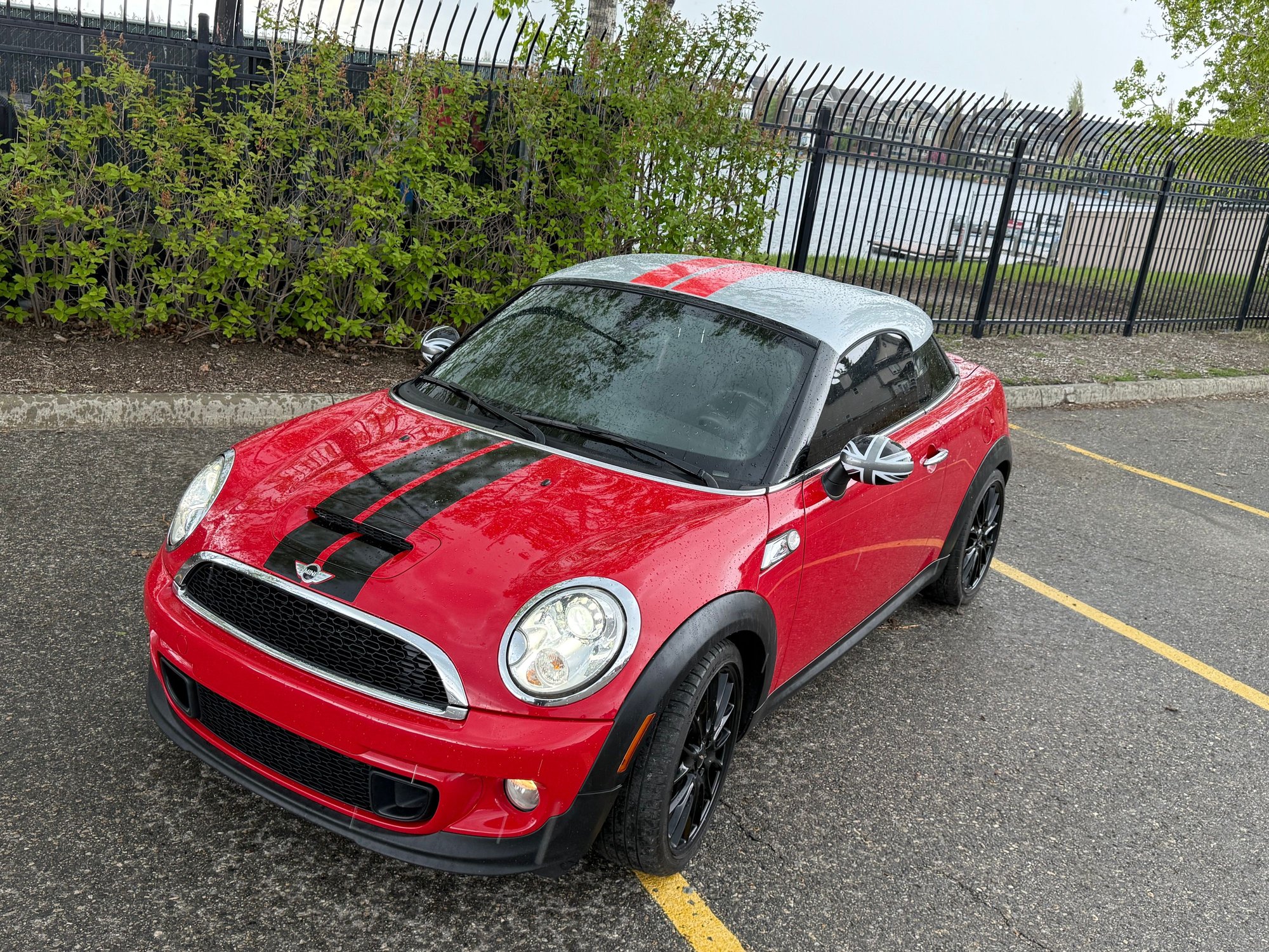

Old May 23, 2025 | 07:47 PM
Velcross's Avatar
Velcross
Joined: Jan 2025
Posts: 96
Likes: 58
From: Canada
Picked it up today
Super happy with the new stripes
