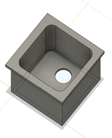

I installed a reverse camera that was made possible with the RCA connection in the aftermarket Android Auto module (UNAVI). The UNAVI module piggybacks on the OEM infotainment, so the car keeps its custom look.
The camera (PixelMan) is mounted in a square hole cut through the rear faux grille.
The mounting bracket was 3D printed (PolyMide Nylon12-CF filament)
