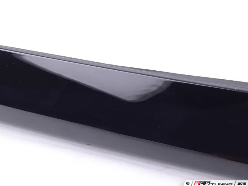

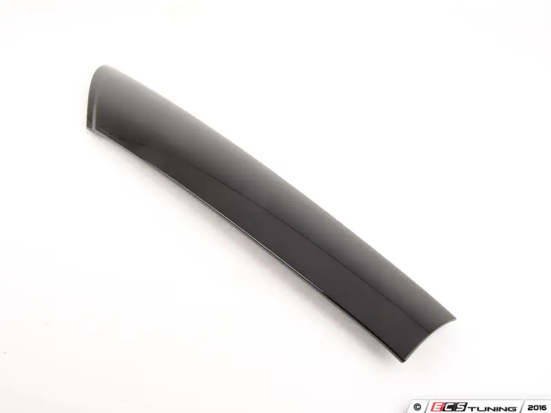

A pillars - They tend to damage and break the clips. 51132758797 and 51132758798
https://www.ecstuning.com/Search/Sit...h/51132758797/

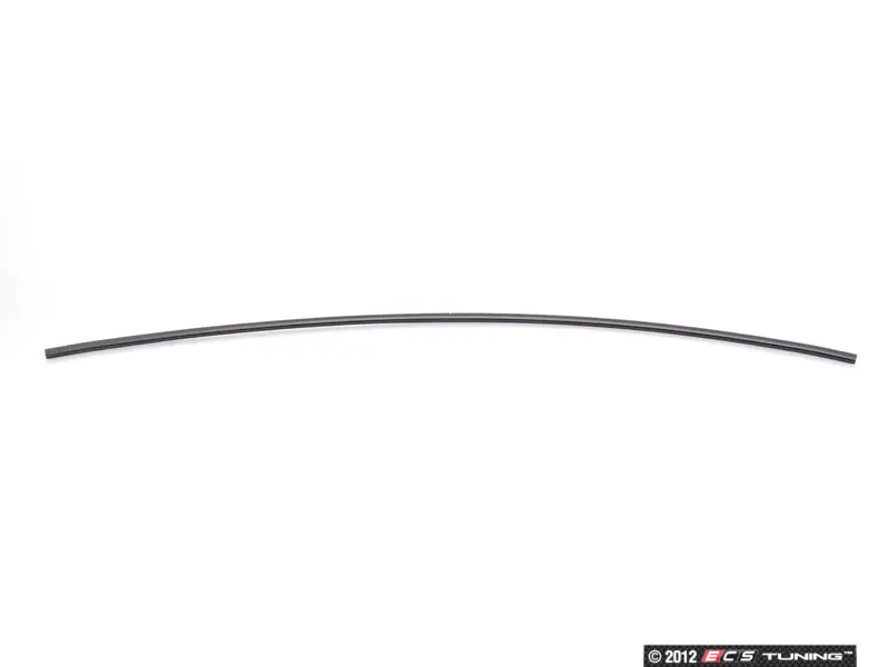

https://www.ecstuning.com/b-genuine-...t/51317351733/ This is needed placed when they do the window, it should come with it. It goes at the top of the windshield.

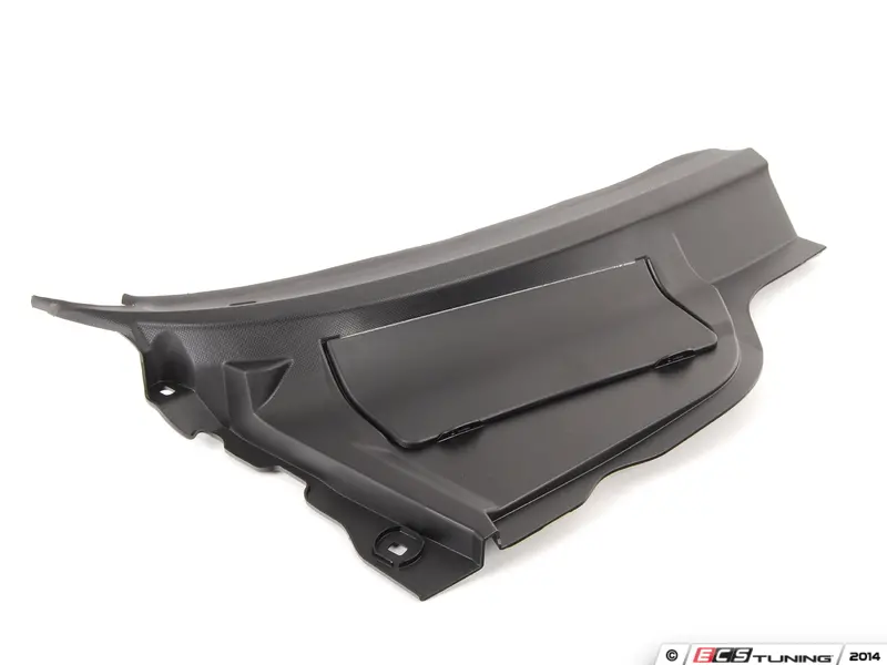

This also is required. 51312756196 as its part of the lower cowls.
https://www.ecstuning.com/b-genuine-...p/51312756196/
