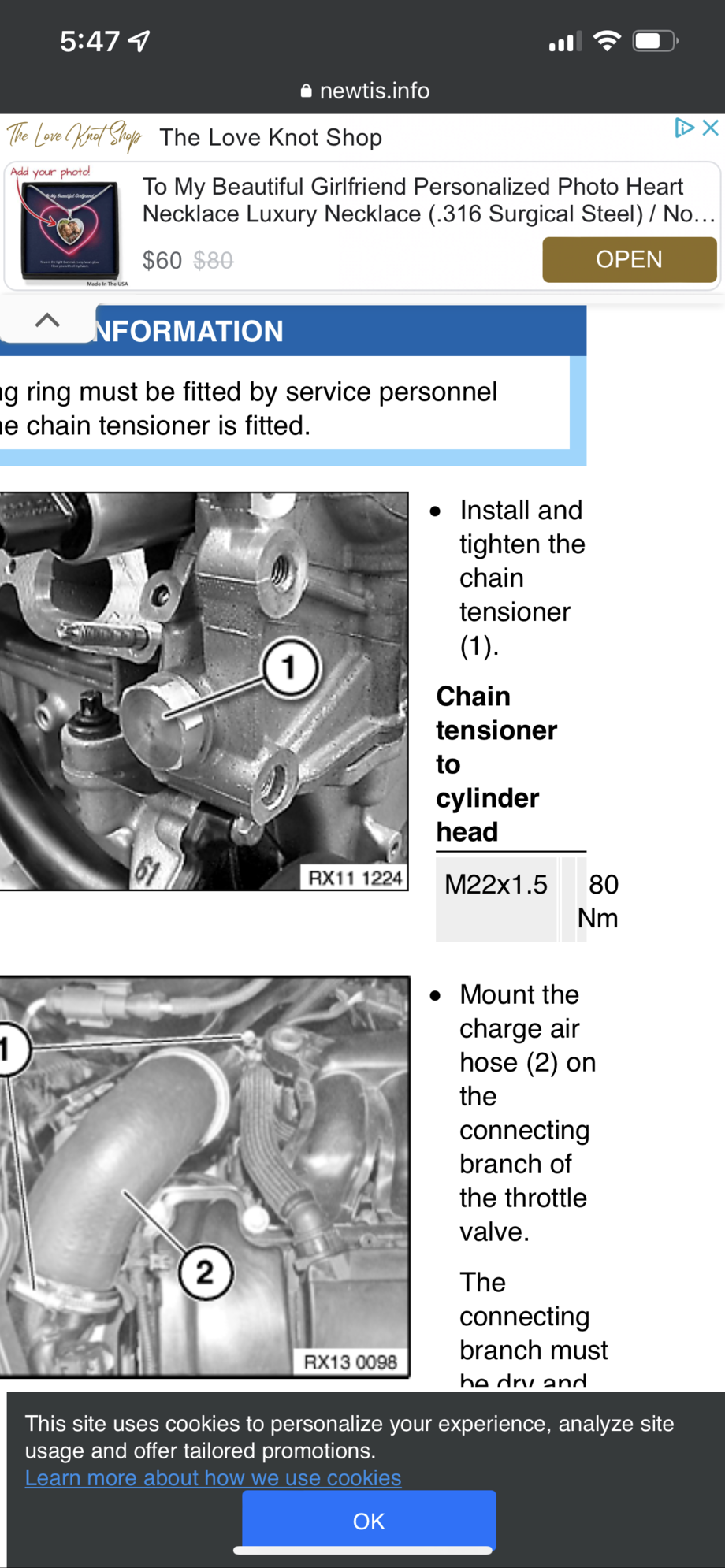

Thank you so much for the reply and images. Yeah, I have the location down but the problem I am having is the plunger of the new tensioner is not allowing the tensioner to seat anywhere near the threads. With the tensioner located at the back of the engine bay, it's like I need to somehow compress the tensioner into the engine and twist it to start the threads. With the positioning under the hood, this is going to be impossible.
I have been manipulating and turning it now this morning for over an hour straight and I just can't seem to get it to thread. I even thought perhaps I need to wiggle the tensioner to get it to "seat" inside of the guide rail or something. I am very puzzled. Every post I've found seems to suggest no one else has experienced this and they just inserted the tensioner and hand tightened until time for a torque wrench.
Thanks again for the reply and help. I'll update the thread if I make any headway.
