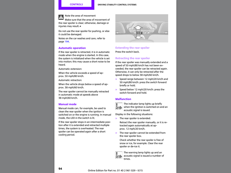

Originally Posted by 483 of 500
I just bought my 2014 Coupe. Is there a way to turn off the spoiler so it stays down all the time? I can see an advantage to keeping it down in freezing rain, etc.
No not really. You can leave it up all the time no matter what speed but if down it will want to come up at 50. The rear active spoiler is part of the designed aero and necessary downforce built into the car. And what was posted is incorrect. If malfunctioned or disconnected you can still drive over 50 but doc will be forced on. U will get a warning on the dash
Just a FYI. If it were to freeze down it will sense the resistance and stop trying. U can still get home. And on my 2013 last winter ( I have a 2015 r58 now ) in NY it was brutally cold and below freezing a lot and it never Froze to the car
See attached owners manual instructions

+1 drivehard.
